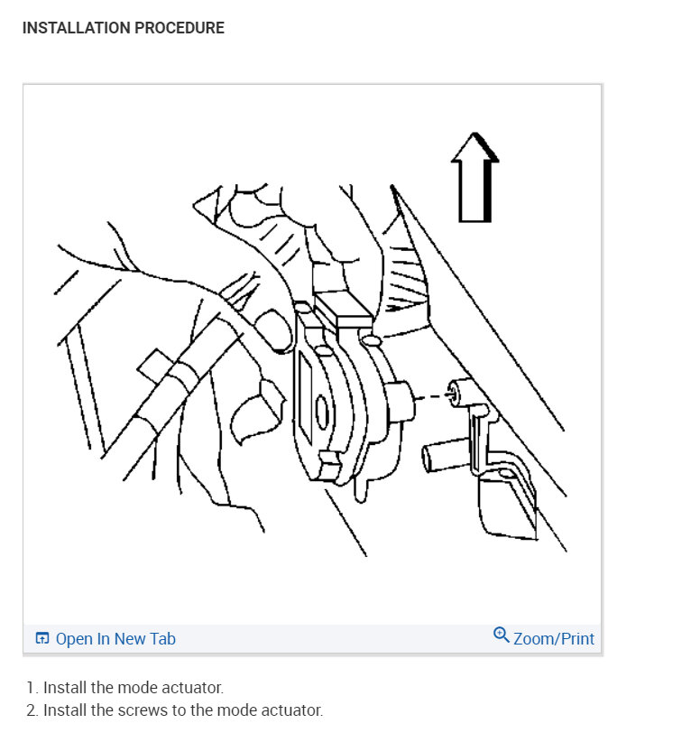

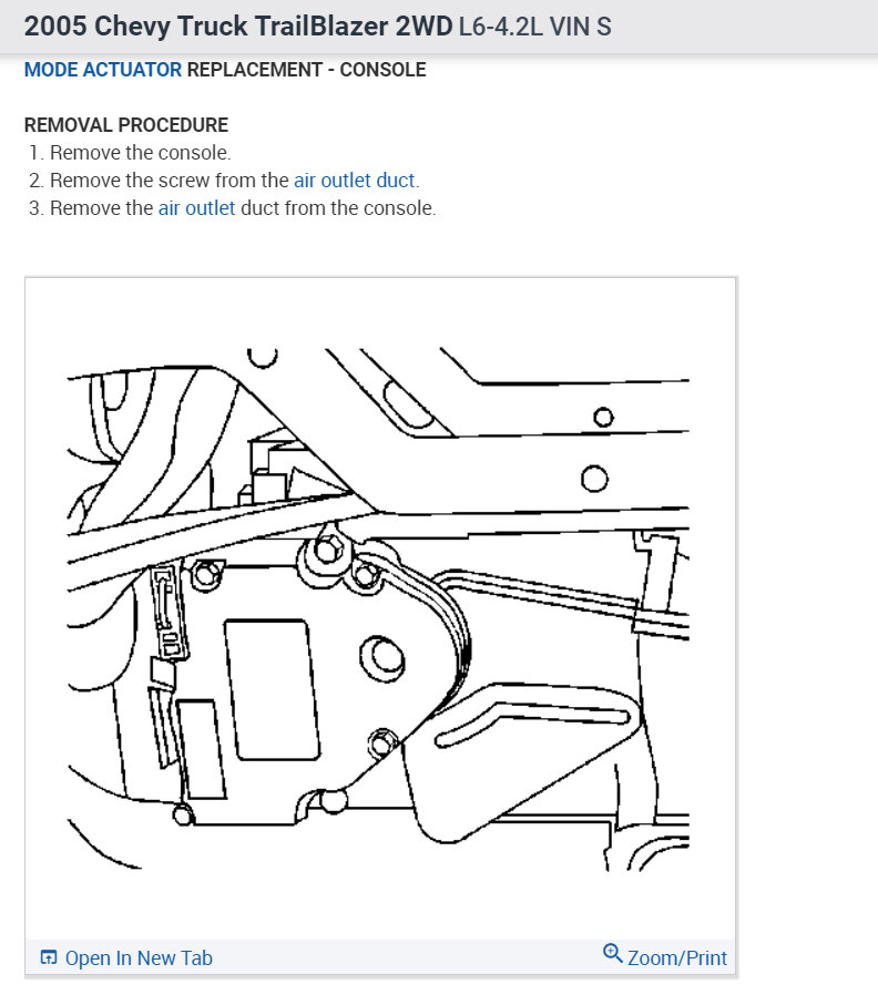

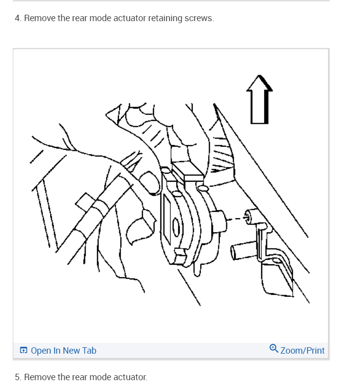

This sounds like the mode actuator is not working here is the location so you can remove it and leave the wires connected to see if it moves throughout the complete range, if not replace the actuator. Check out the images (below). Please let us know what happens.
