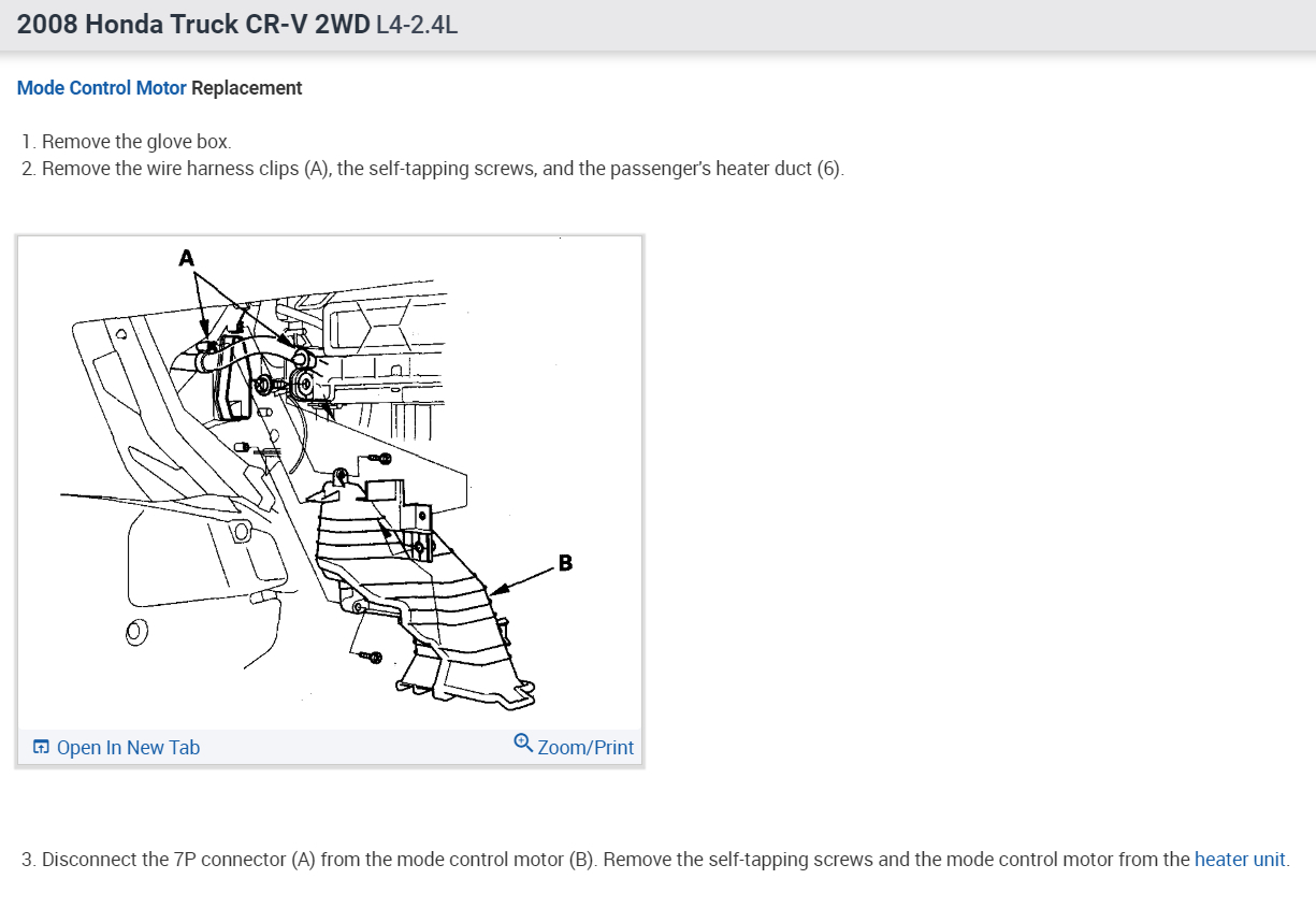

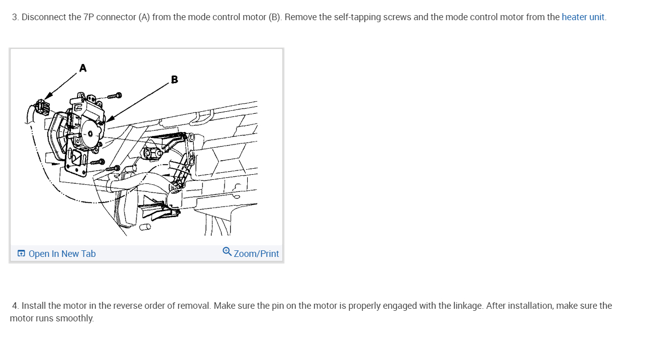

This happens when the mode actuator goes out. here is a guide that will walk you through the steps with diagrams below to show you how on your car:
