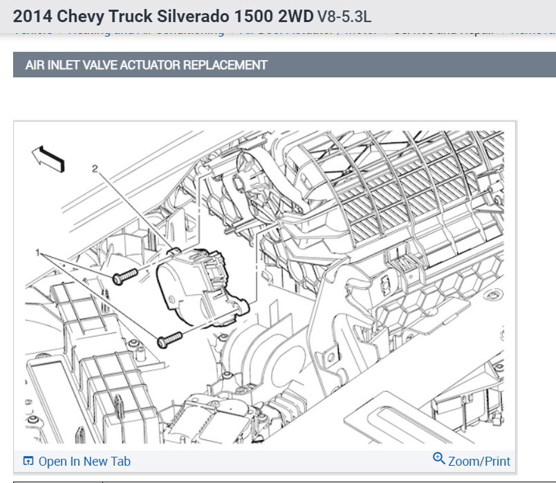

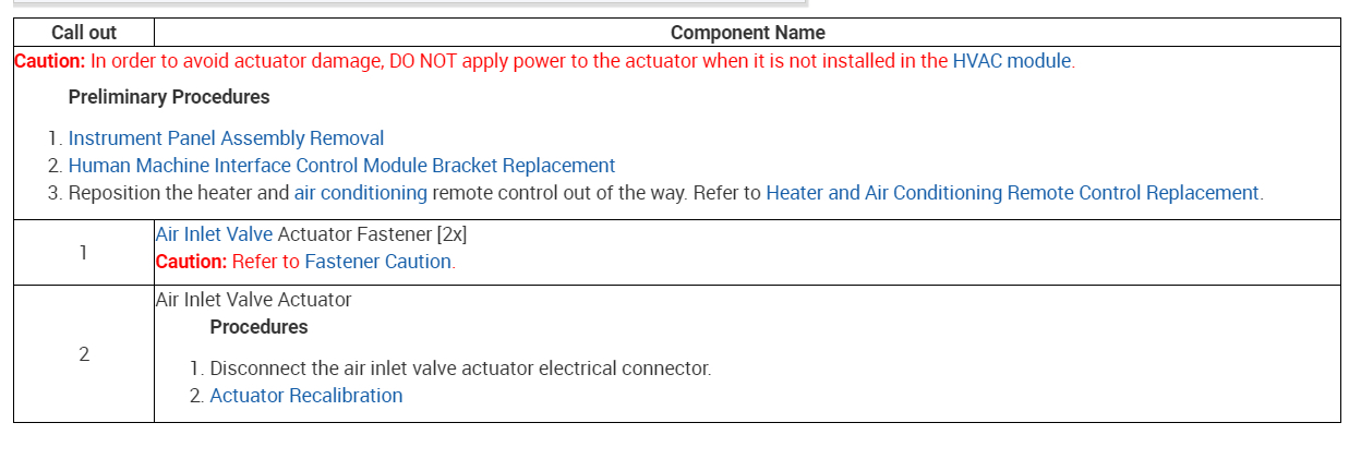

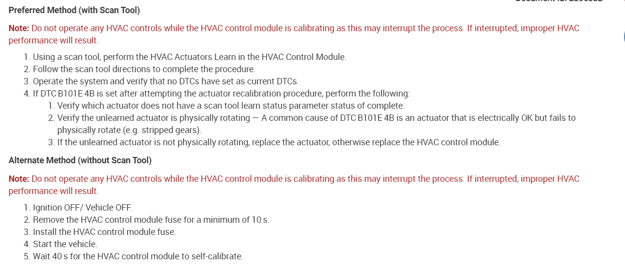

So, it sounds like you have a defective replacement blend door actuator. Here is the correct way to change the unit out and do the calibration. Check out the images (below). Please let us know how it goes.
