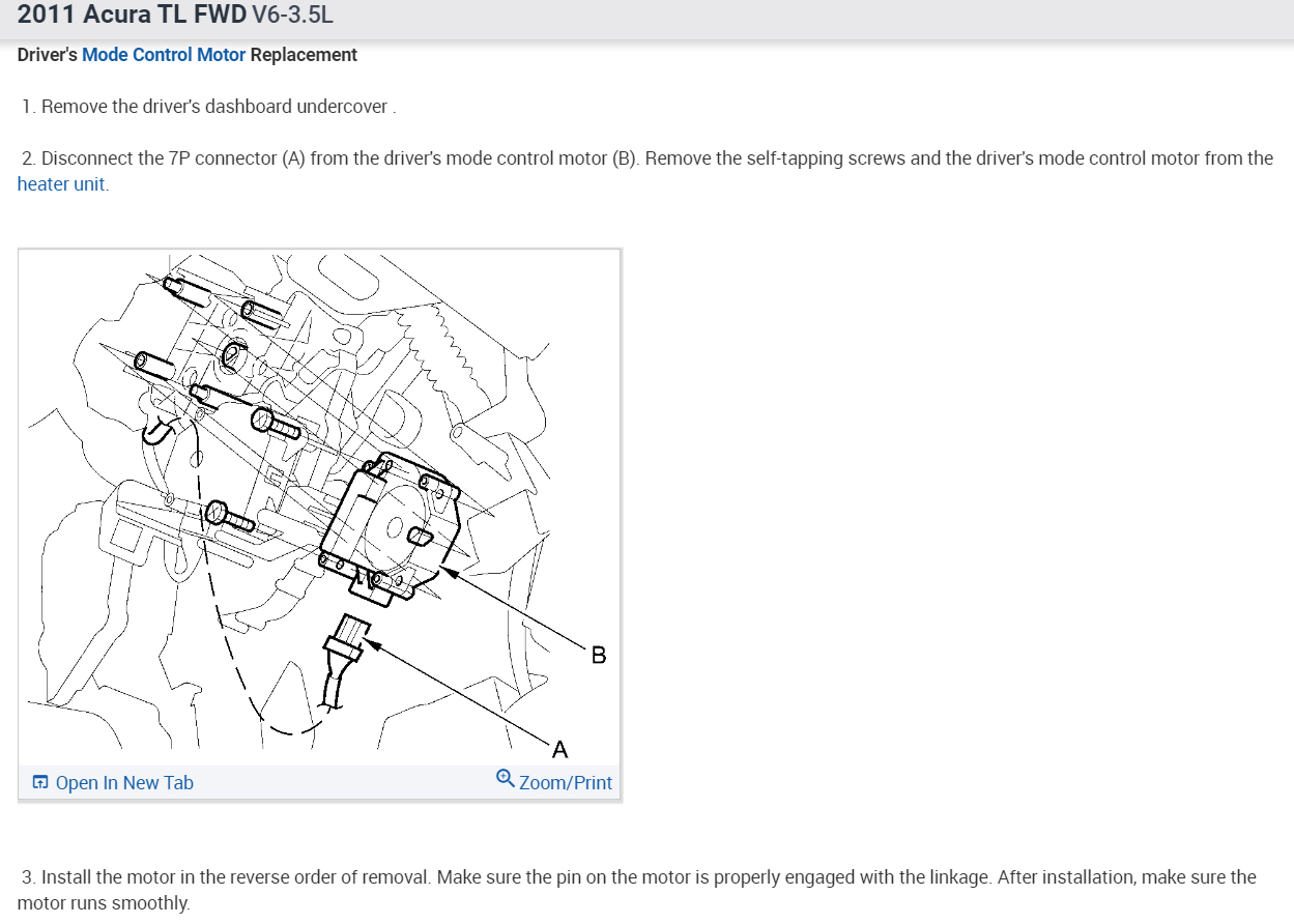

It sounds like the driver's side mode actuator is weak, can I ask which brand the replacement part is? Here is how to replace the driver's mode door actuator correctly and to make sure we are on the same page of its location. Check out the images (below). Please let us know what you find.
