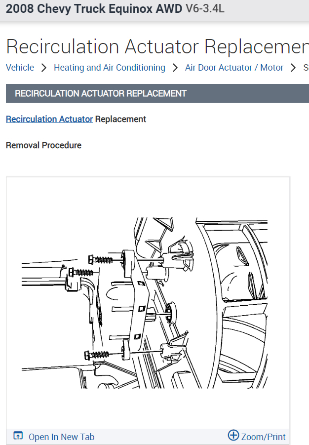

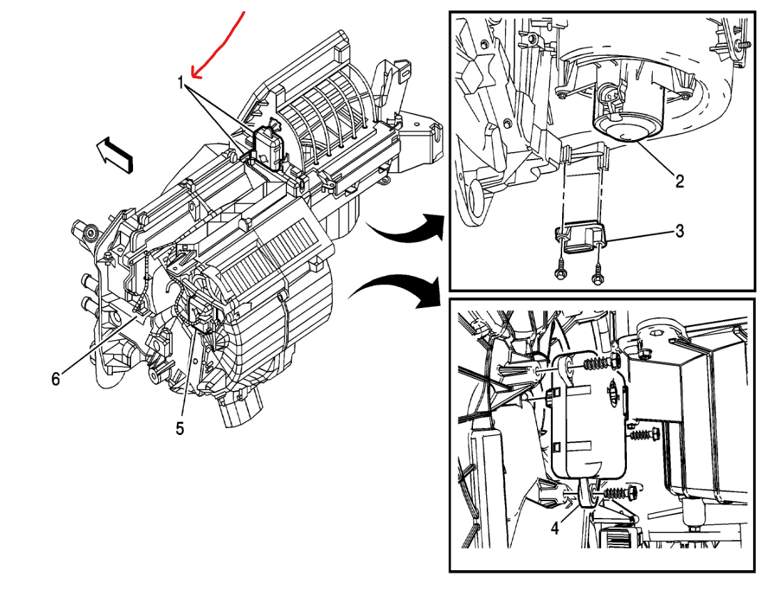

Yep, you can try unplugging the actuator in the recirculate mode or we will need to rig the blend door actuator, so it does not move the internal blend door. Here is the location of the actuator in question. You may be able to just lay the actuator off to the side and force something into the blend door to have it stay in the recirculate position. Check out the images (below). Please let us know what happens.
