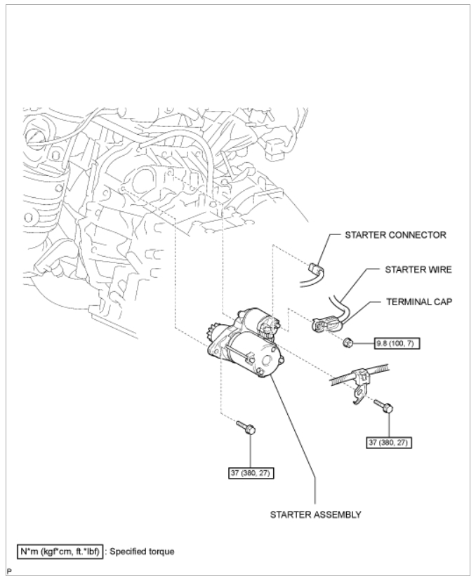

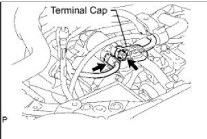

Yep it sure sounds like you need a starter. Here is a guide to help you see what you are in for when doing the job.
Here is what it will be like for your car (below)
