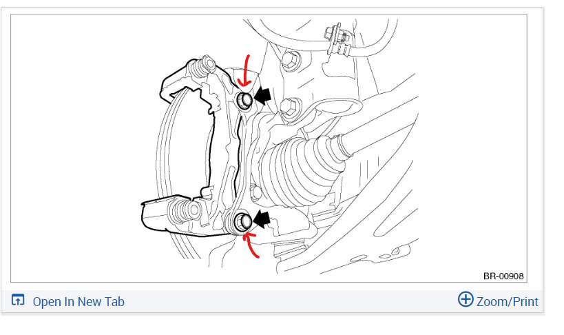

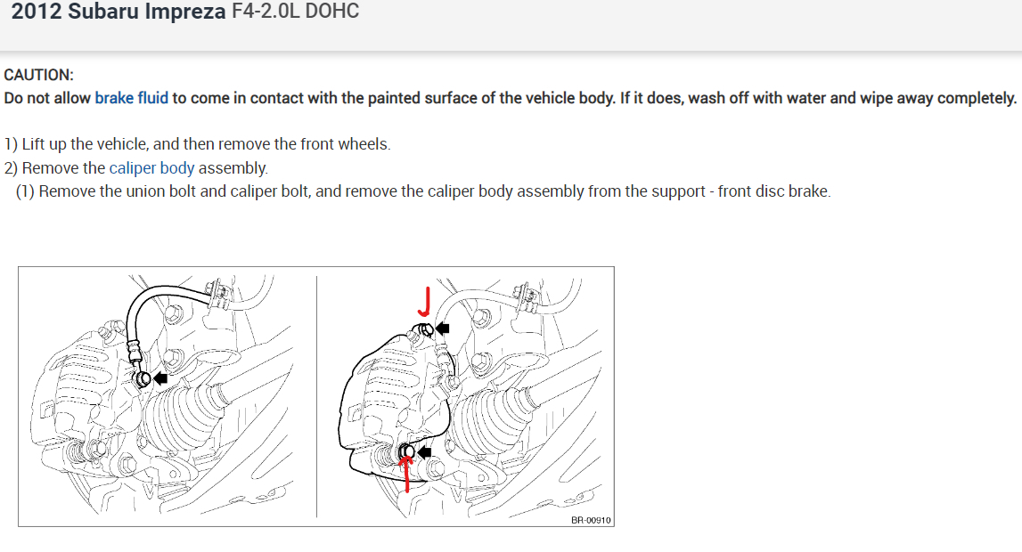

Does the noise change when you hit the brakes? "Rubbing sounds" can come from the backing plate of the brake system. Can you please shoot a quick video with your phone so I can hear the noise? That way I can tell for sure what's going on. Also, if the brake caliper is loose it will make sounds as well, if the mechanic did not tighten the bolts, they could have fallen out which is common. Here is what you want to look for, use a flashing for the inspection. Check out the images (below). Please let us know what happens.

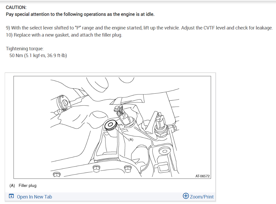

When you say serviced did they change the transmission fluid? If so the incorrect fluid will make the transmission have noises.
Fluid Types
CVT Fluid
Type .................... SUBARU CVT Oil for Lineartronic
Capacities
CVT Fluid (CVTF)
Capacity .................... 12.6 - 13.1 qt (11.93 - 12.43L)

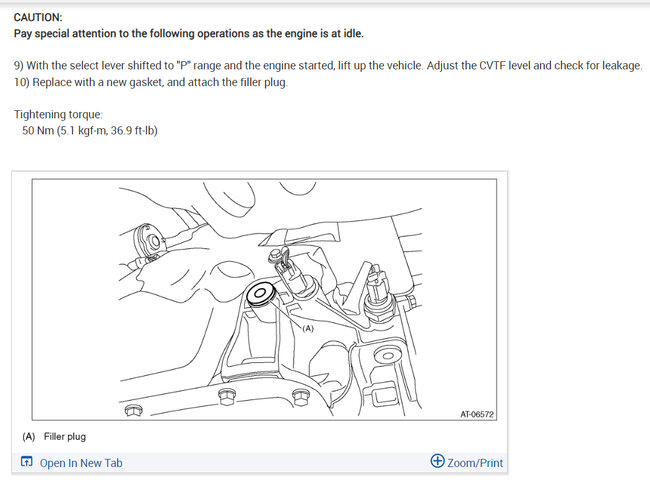

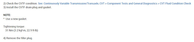

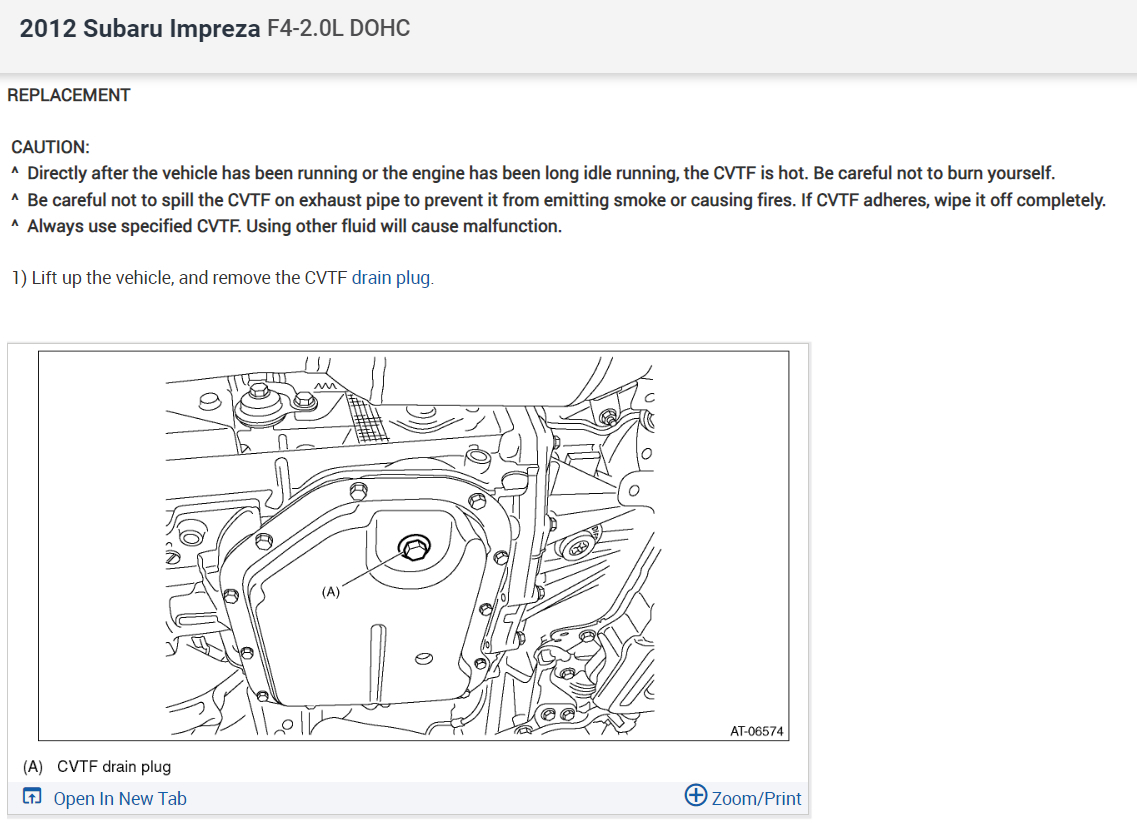

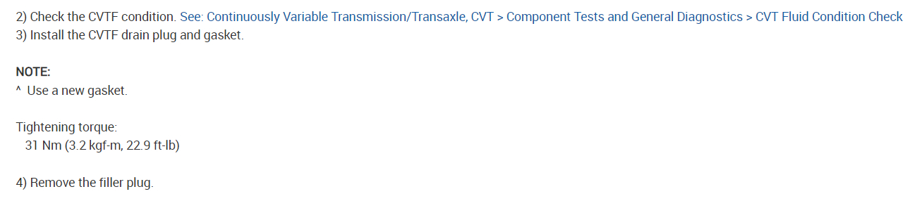

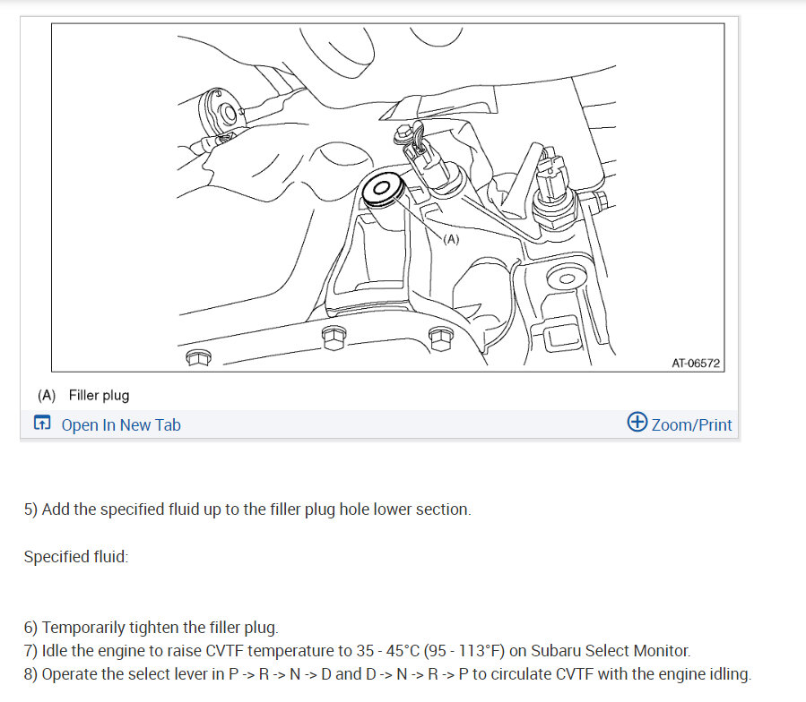

This car has the CVT transmission which the main drive band goes out on internally. Can you tell if the fluid is burnt? If so I would change the fluid out, here is how. Check out the images (below). Please upload videos in your response of any problems so we can see what to help you with.
