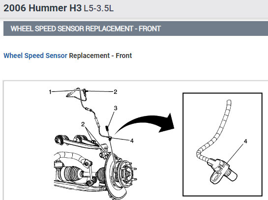

dash trouble lights on, abs, brakes, traction, check engine. I checked it out and I need the right front wheel sensor.

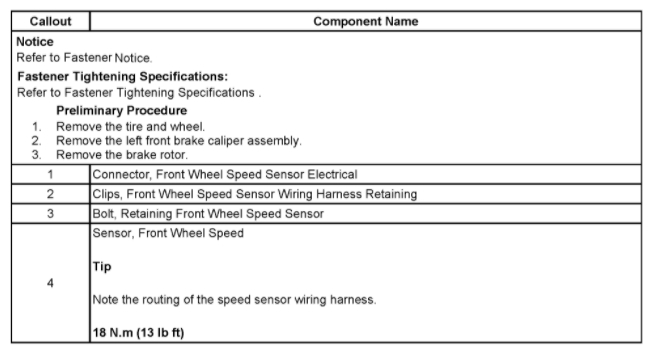

Here is the information you requested. This is a tutorial for you to view on how to replace a wheel speed sensor:
https://www.2carpros.com/articles/how-to-replace-an-abs-wheel-speed-sensor
I've attached picture steps below on how to replace the wheel speed sensor on your vehicle. Hope this helps and thanks for using 2CarPros.
