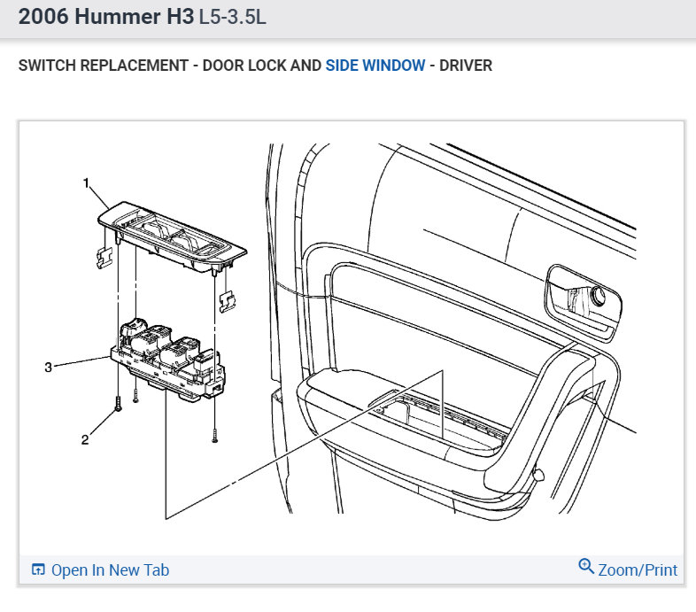

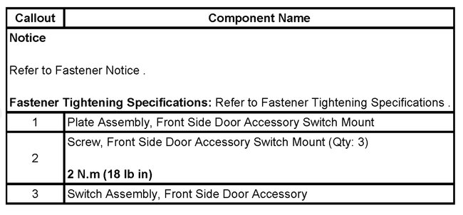

It sounds like you knocked out the driver door switch when you reconnect the battery from a voltage spike. There is a logic module inside the switch. Here is the location to help you fix the problem. Check out the diagrams (Below). Please let us know what happens.

Thank you for this post, I got a new switch for $98.00 and installed it all fixed! I love this site.
