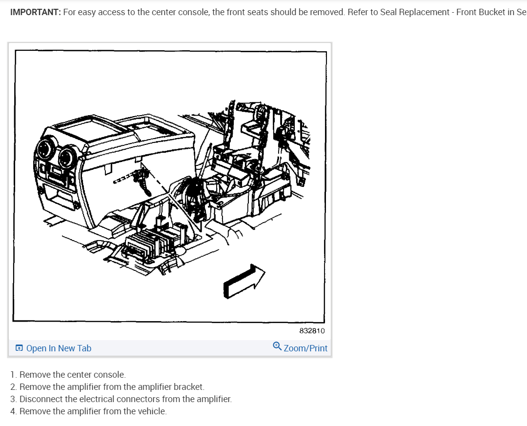

The factory amp is located under the center console. Here is how you can replace the amplifier. Check out the diagrams (Below). Please let us know if you need anything else to get the problem fixed.
