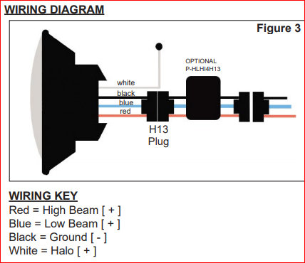

Hello again.
I have found a picture and I have attached it for you. Having just the low beams flicker means it is not getting enough power. Check the blue wire connection to make sure tight, no corrosion, damage, etc. If you have a voltmeter make sure that circuit is getting 12 volts. Hope this helps and let me know how things are going. Thanks again for using 2CarPros.

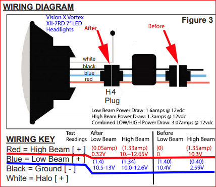

Hi Danny,
Here are the test readings I have taken before and after the High four adapter P-HLHI4 that allows low beam to be on with high beam on. I took readings for both the red and blue wires, before and after, when the lights were on high beam and low beam.

Hello again.
Looking over your readings. Did you install this or a shop? Just curious to know if this setup has a Ballast as well.

Hello again Ross.
Just curious. Were you able to inspect the ground and low beam wires? If they look good I would like you to try something. Bench test the light (hook it up directly to the battery) to check the high and low beam. This will confirm there is an issue with the light. Hope this helps and hope to hear back from you soon. Thanks again for using 2CarPros.

Hi Ross.
Well, there lies the problem. It is in your wiring. You should really double check the ground. Where the bolt/screw attaches to the frame use some sandpaper to ensure a good ground. Check for any signs of a bad/loose connection in all the wiring. Did you install or a shop? Hope all this helps and thanks again for using 2CarPros.

ROSS CARTY
  • 8 POSTS
Thanks Danny,
I jumpered the ground to the battery and there was no change in the lights.
When I jumpered the power directly to the battery and the low beam worked a lot better. They were twice as bright.
Do you still think it is a ground issue?
Ross.
