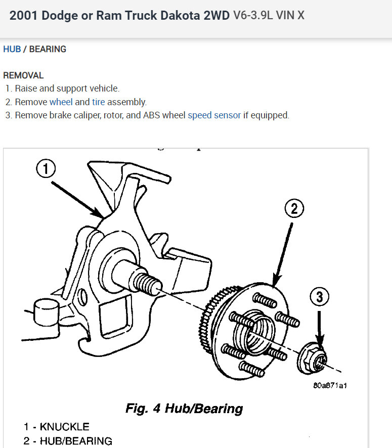

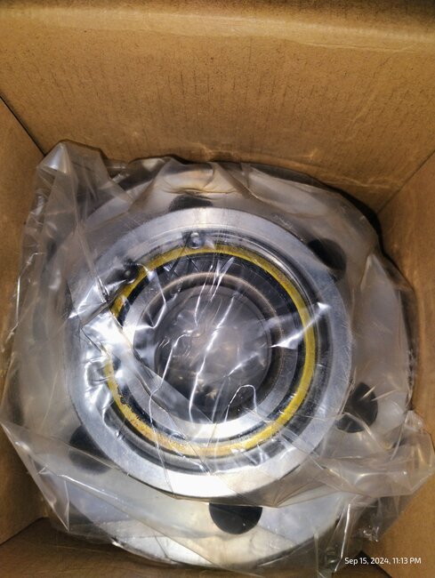

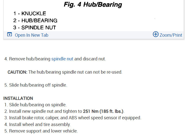

I'm hearing a growl or steady hum noise as I'm driving, and it gets a tad louder when going faster. If I slow down fast, it lowers or lessens. It doesn't do it at park. Going 50 MPH it is not as loud. I don't notice a difference on turning but going thru drive thru I hear a little tiny pop or going over hum on road at timed. I'm going to change the 2 front hubs though not a lot of play on tire test. What else should I look at?

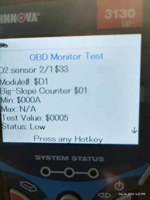

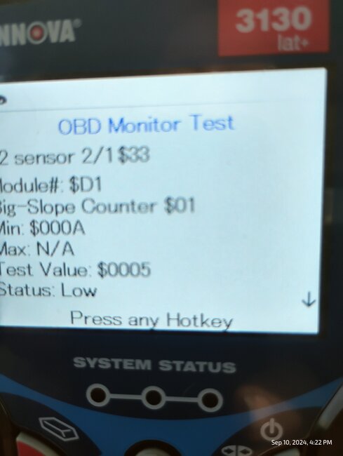

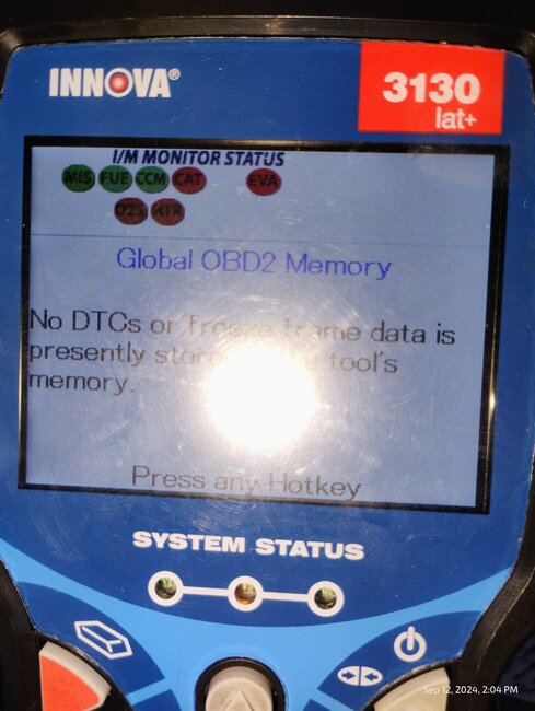

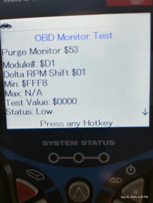

Also, at times I'm getting a catalytic code p0420 insufficient. So, I'm not sure this factors it ..02 tests show a few saying low on them an 1 says high. The cat tests say normal on some an high on one ..not sure if that's a indication or just what it's measuring but the temperature or use. Sometimes it seems a bit sluggish on acceleration.
