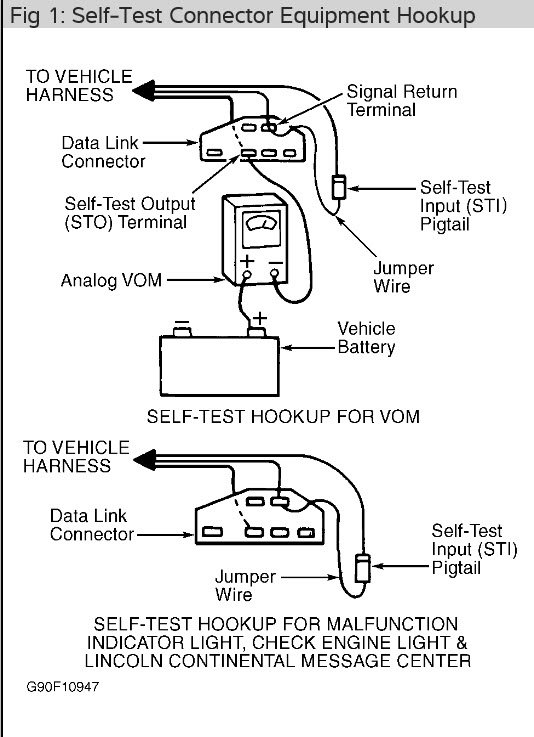

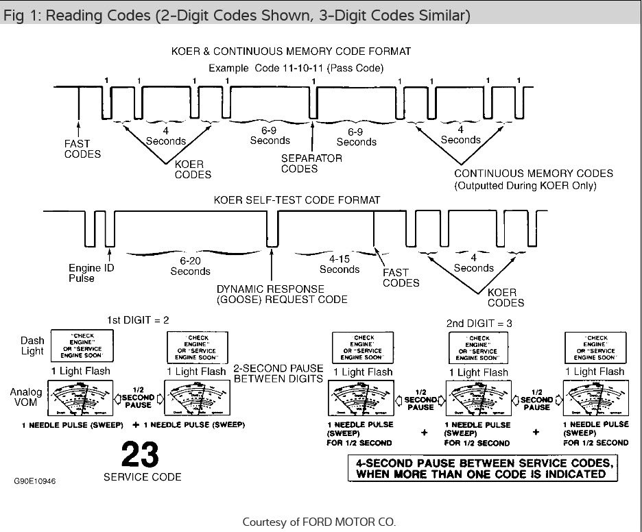

scan for codes first you probably can do this yourself as it is OBD1. see pictures for how to do it and read codes at top of our site is repair guides open that and look for OBD1 codes.

Here is a link to an article that features written step by step instructions and pictures explaining how to do the scan yourself, also I have included a link to our YouTube channel with a how to video on code scanning. Most scanners are inexpensive to purchase, you can purchase one online from sites like Amazon.com. Once you have the codes please get back to us so that we can further assist you. We are always happy to help.
