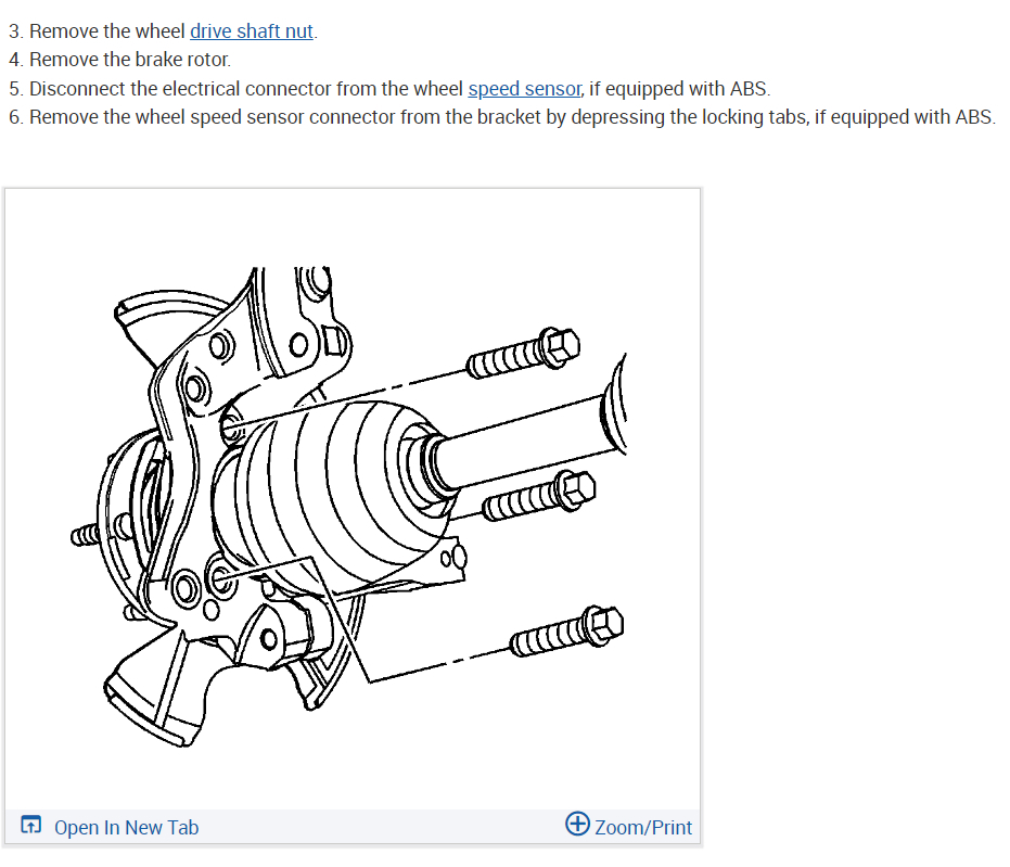

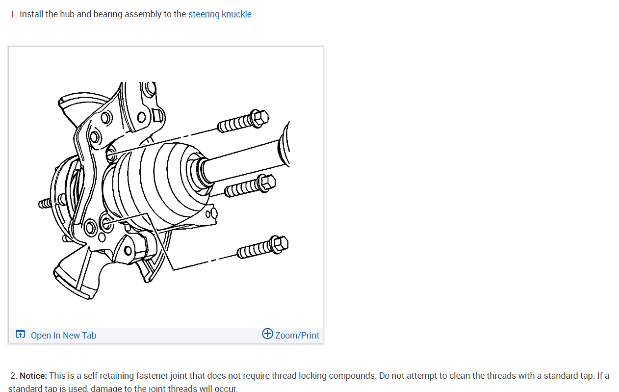

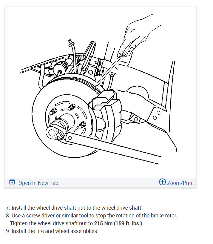

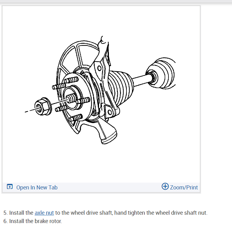

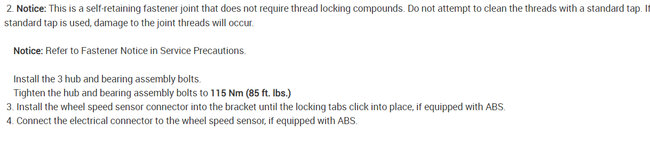

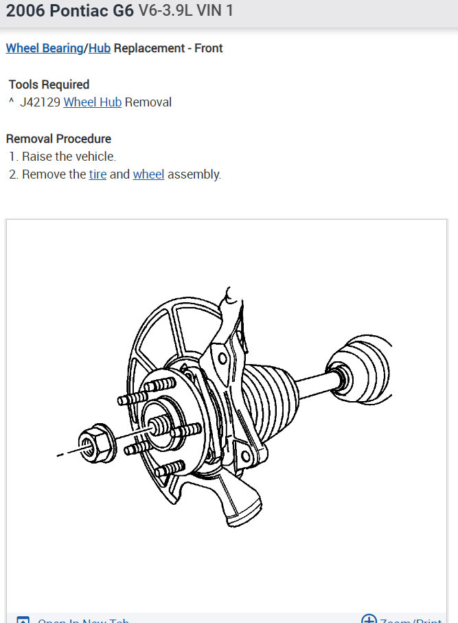

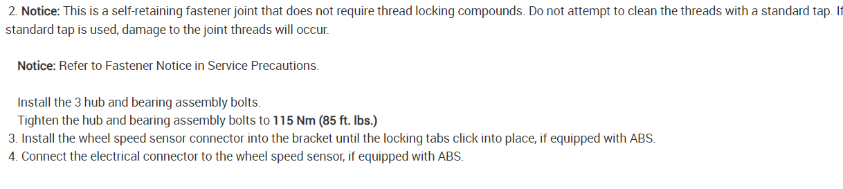

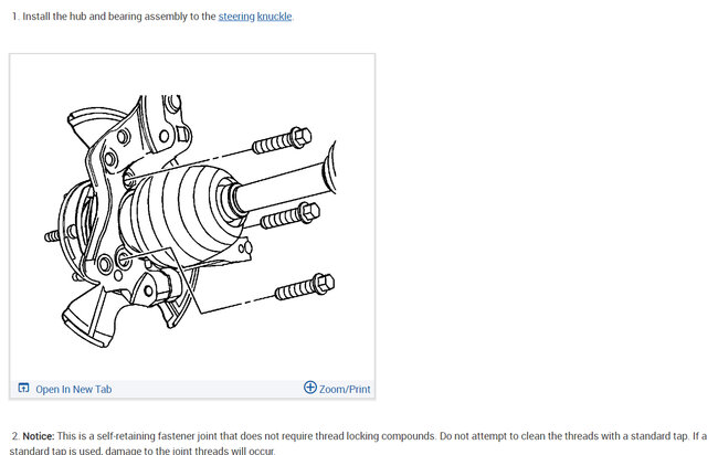

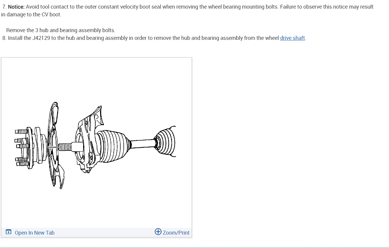

Sure, this is common for the bearing hub to make noise when going out but please check the tire tread for "feathering" as well. Here is how to change the front bearing hub out for a new part. These instructions have the torque specs as well. Check out the images (below). Please let us know what happens.
