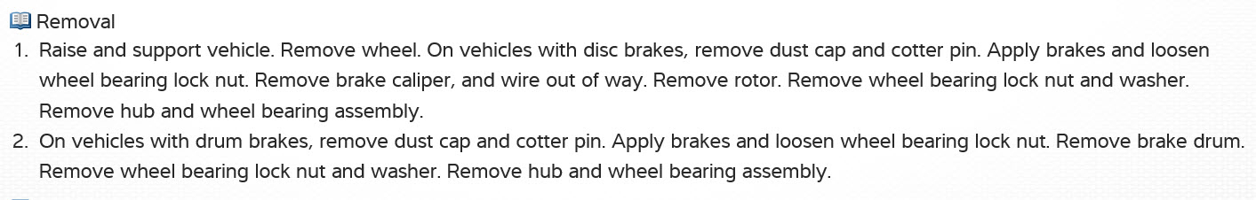

I'm trying to change my hub bearing but can't take the old one off I have taken every bolt around the hub bearing off but can't seem to get it off. And does the rear hub bearing have cotter pin?. If so how do I access it through the cover?.

which are you removing rear? see pic for rear removal
