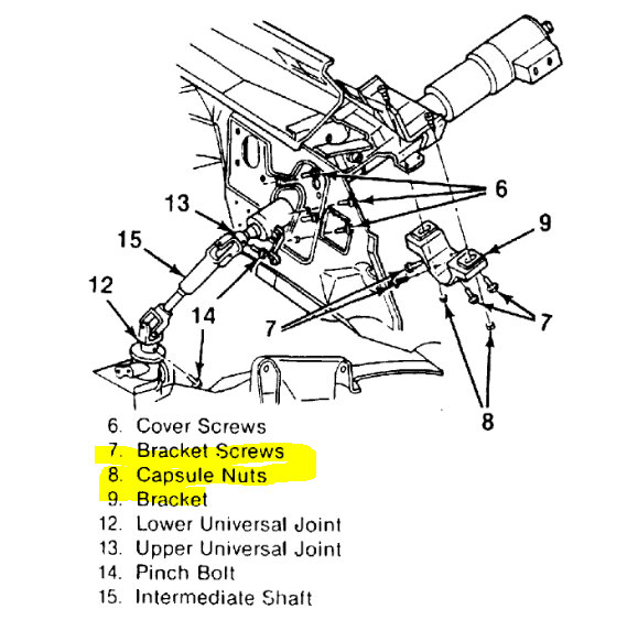

I cannot get the steering column to lower (I have removed all bolts), so I can remove and replace the ignition switch. Why doesn't the steering column lower?
Apr 25, 2023 at 9:00 AM
Are you replacing the ignition key lock cylinder, or the ignition switch itself? Also, you indicated removing all bolts.
Take a look at the pic below. Did you remove all of the highlighted retainers? Also, I need to know if this has a tilt wheel or not.
See pic below.
Apr 25, 2023 at 7:36 PM
BOB%
  • 70 POSTS
I never removed the cover screws. On regular cars just removing the bolts would lower the steering column. I'll try #6(Drawing) bolt removal. I got to replace the Main Switch which is on the column itself. Thank you for the prompt and useful message. BOB.
