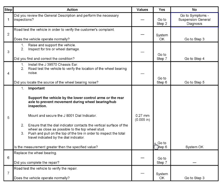

Replaced tires, had aligned, is there a bearing going out?
Nov 20, 2019 at 3:00 PM
Yeah. More than likely this is a bearing. Can you slightly swerve side to side and see if it changes the noise. If it does then it is bearing.
Here is a bit of information on how to figure that out. Let me know what you find. Thanks
https://www.2carpros.com/articles/car-howling-noise
