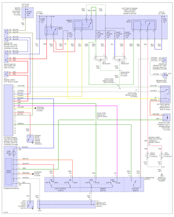

Can you guys please help me to turn the DRL off? I don't like that feature. Thanks in advance.
Jan 28, 2019 at 2:10 PM
SCGRANTURISMO
CERTIFIED EXPERT
4,897 POSTS
HI Jesus, my name is Alex and I will be helping you. Here is a wiring diagram of your vehicle. It looks like the DRL fuse (7.5A) being removed should do the trick. Thanks, and let us know if can help with anything else.
