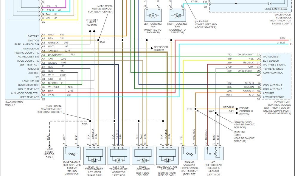

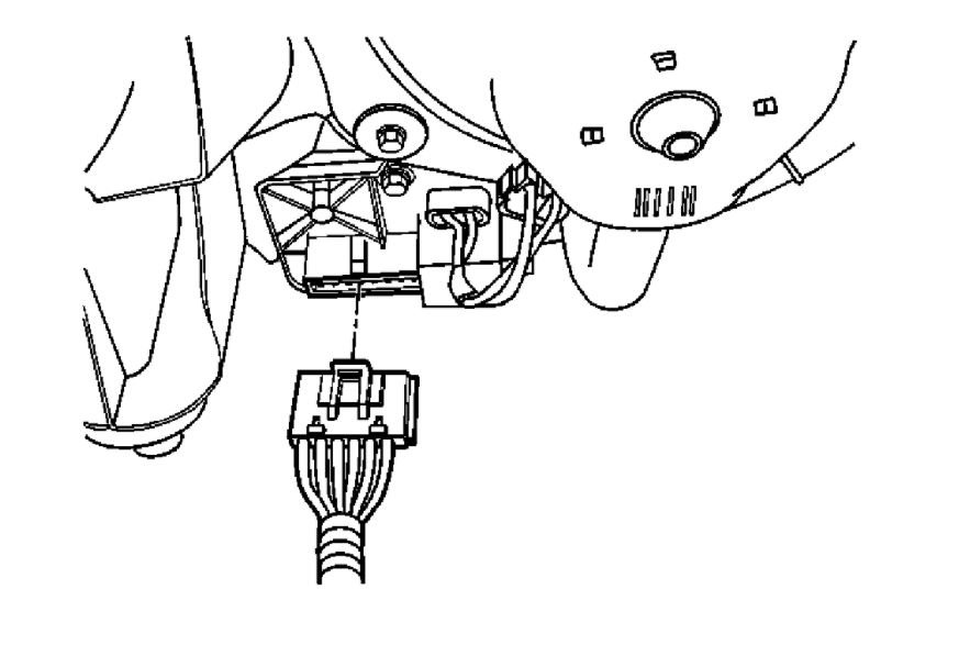

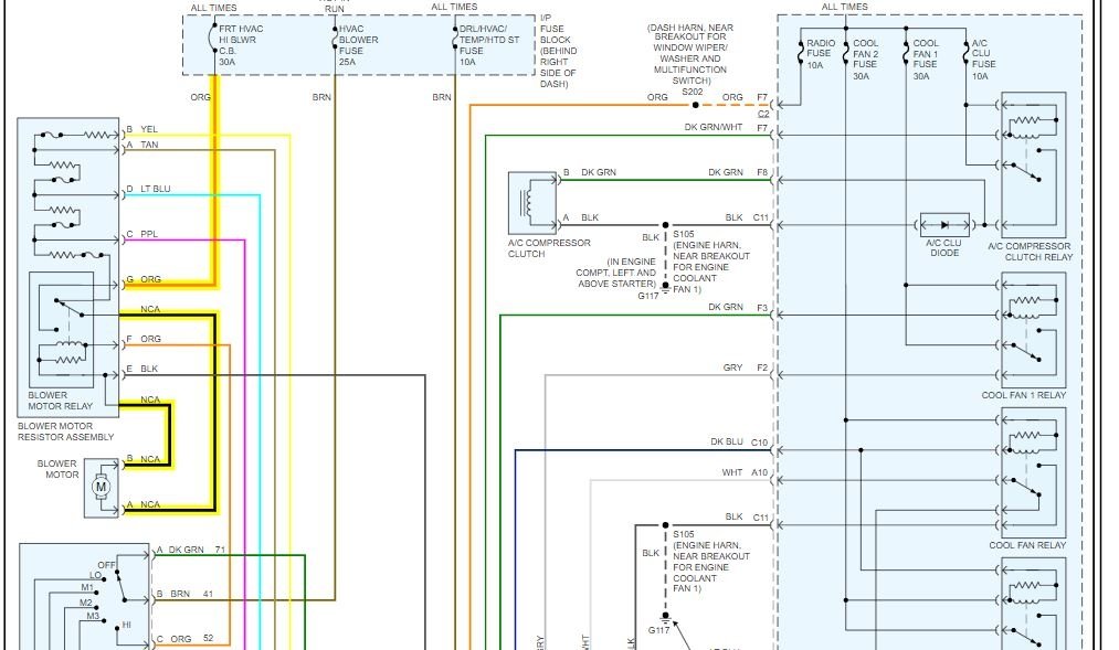

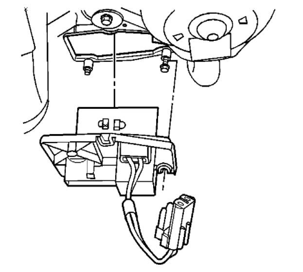

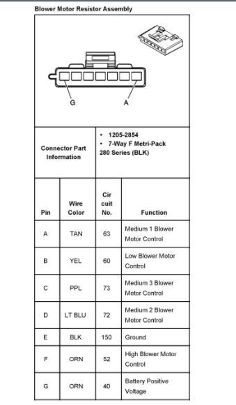

I'm trying to figure out a way to turn on the blower motor fan without using the climate control module. Reason for this is; the climate control module went bad (one of the connection melted) and was on defrost when it happened. I still need to use the car to get to work and back but I can't because the windshield gets too foggy. Are there wires that I can jump to force it on? If so, which ones do I need to jump and what's the best way to do it? This would be temporary until I can afford to get it fixed.
