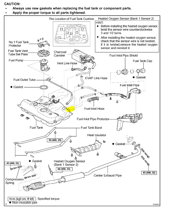

You will have to remove the fuel filler tube from the tank and then use a siphon to remove fuel.
See attached picture for reference.
