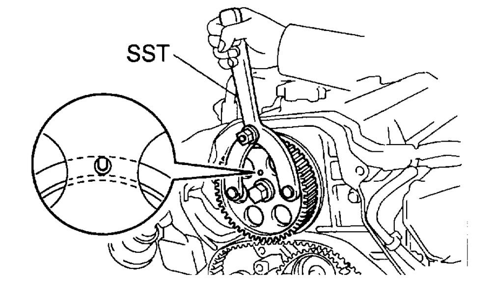

I miss set the timing. can you help me set the timing right please?

The cam gear has a dot and I posted a picture of it for you. It has to be straight up.

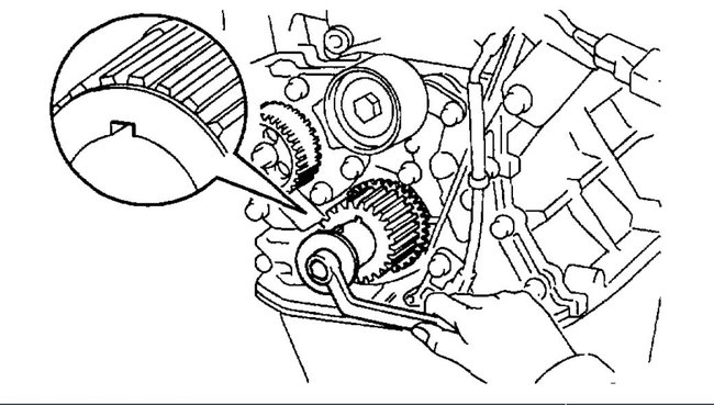

The crank gear has a dowel pin. that pin goes straight up as well.
I attached a YouTube video as well for you.
