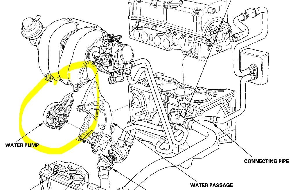

How do I replace the water pump on this car? I cannot find any diagrams or how-to videos online. A mechanic said it would take a while to do due to lack of space.

Hello there, it looks like the water pump is right underneath the alternator. It is in a tight location but only the serpentine belt needs to come off to get to the water pump.
