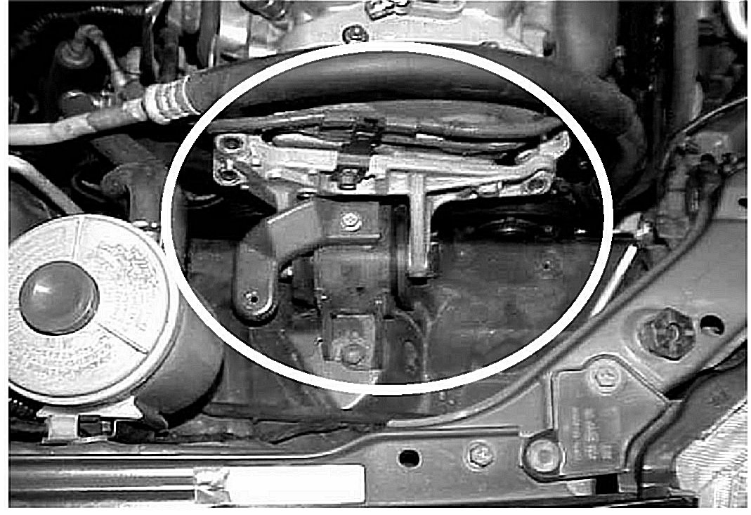

1. Record the radio presets. Place the vehicle securely on a hoist. Disconnect the negative battery cable. Raise the vehicle and remove the right engine under cover. Lower the vehicle enough to work in the engine compartment. Position a floor jack under the oil pan. Place a piece of wood, such as a 4 inch piece of a 2x4, between the pan and the jack pad. Raise the jack just enough to relieve the weight of the engine from the engine mount.

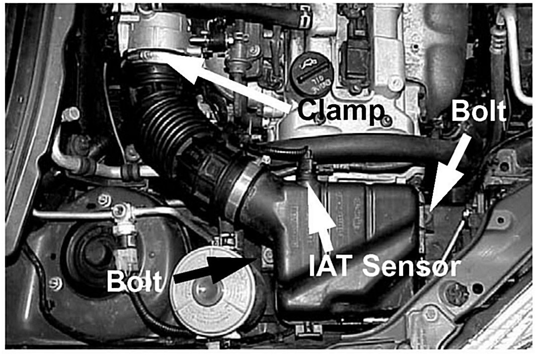

2. Pull the Intake Air Temperature (IAT) sensor out of the air cleaner grommet with plug connected. Loosen indicated clamp and remove two indicated bolts. Pull the air cleaner assembly out of the engine compartment.
pic 2
3. Remove the engine mount bracket and engine mount as an assembly.
pic 3

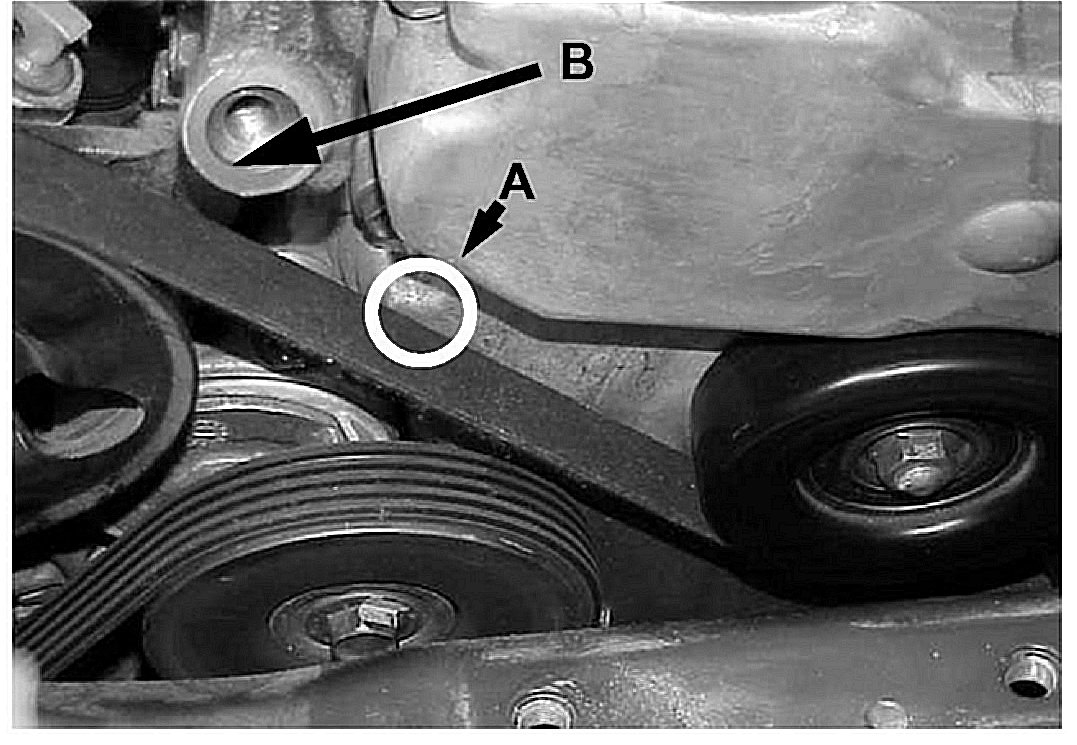

4. Pry the P/S Pump Pulley outward with a small pry bar or flat screw driver at position "B" to remove any thrust play. While holding pressure on the pulley measure the clearance between the timing cover and the serpentine belt at point "A" using a feeler gauge. If the distance measured is between 2.0 mm and 3.3 mm continue to the next step. If the distance measured is less than 2.0 mm or greater than 3.3 do not continue. This procedure has already been done or there is another problem that must be diagnosed. DO NOT bend the pulley, only slight pressure is required.
pic 4

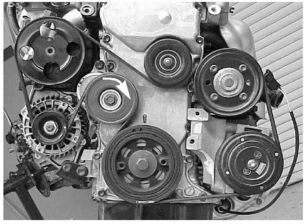

5. Remove the Serpentine Belt by turning the tensioner in the indicated direction.
