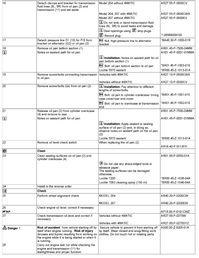

I know this is going to be extensive, but I need to replace the pan after an incident. Can you see if you can find me the instructions?
Jan 14, 2025 at 2:16 PM

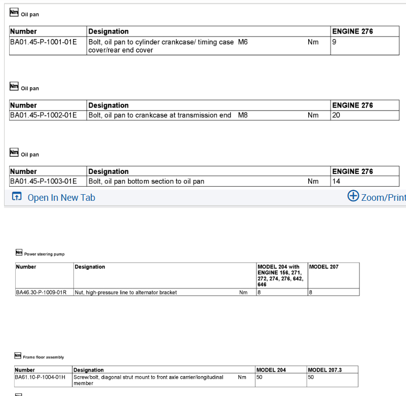

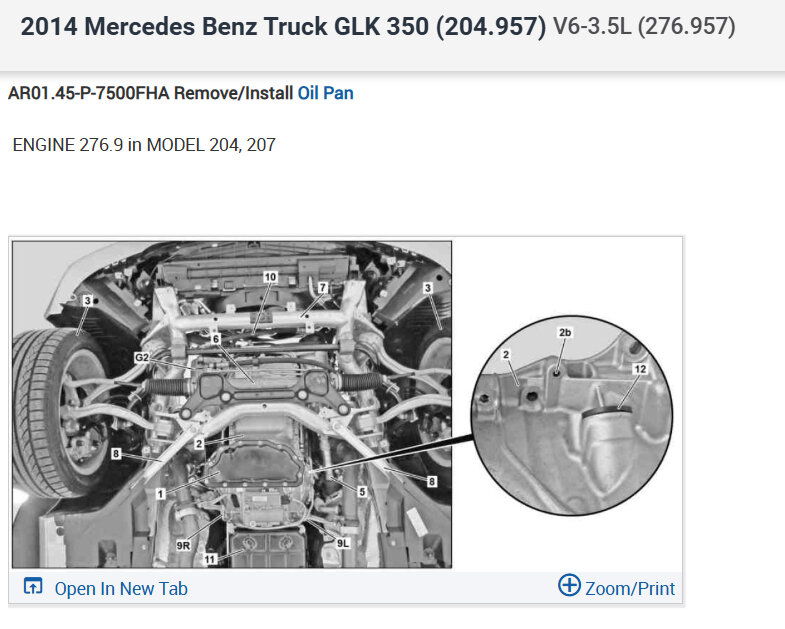

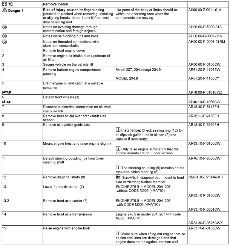

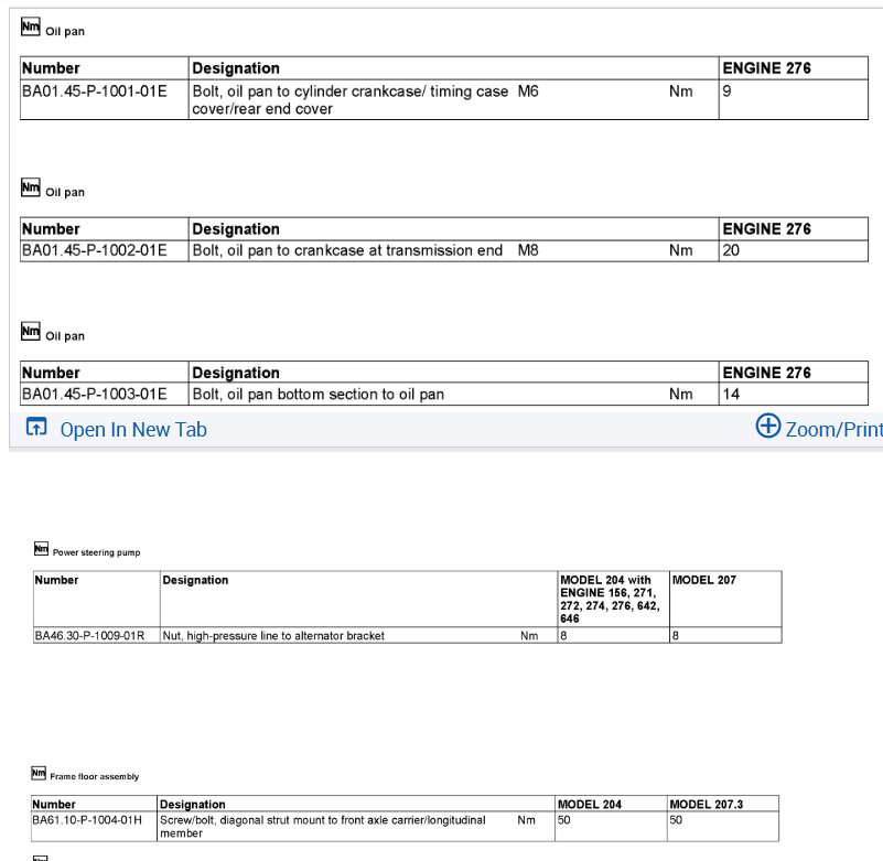

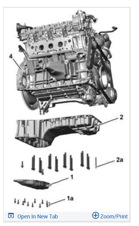

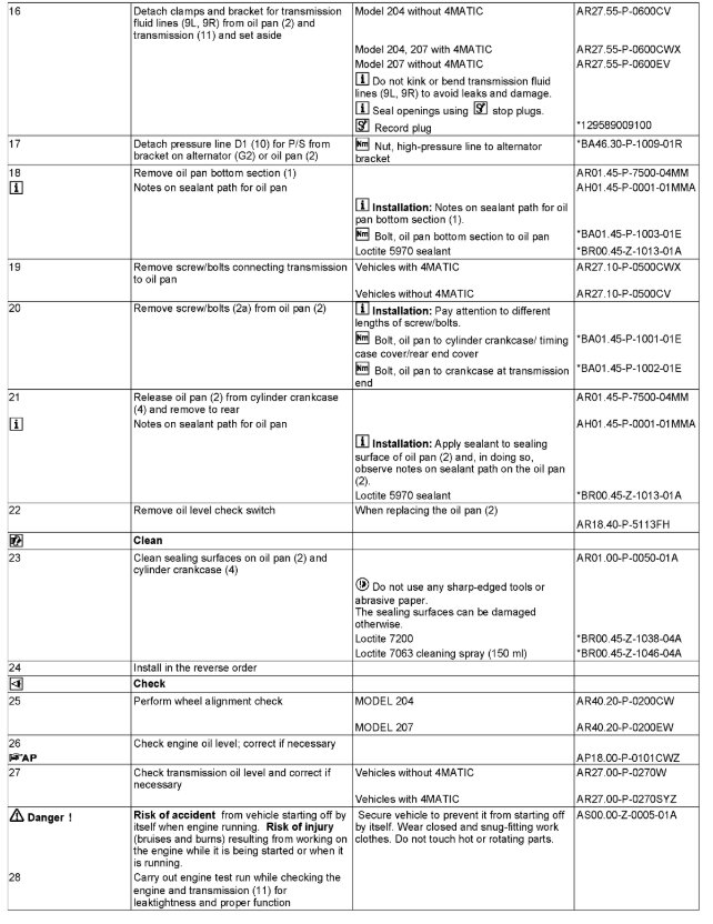

Yep they get 11.6 hours to do the job, so it is a mission. Start by disconnecting the battery and drain the engine oil with filter. You will need to raise the car up, here are the instructions on how to change the upper and lower oil pan. Be sure to use sealant when reassembling. Check out the images (below). Let us know if you need anything else.
Jan 15, 2025 at 11:57 AM
BHAMDOC1
  • 101 POSTS
What does remove front axle transmission mean?
Jan 15, 2025 at 12:04 PM
I believe they are talking about the front sub member with the steering rack.
Jan 16, 2025 at 9:09 AM
BHAMDOC1
  • 101 POSTS
okay, so I doubt the transmission needs to be removed.
Jan 16, 2025 at 9:24 AM
I don't think so, it looks like the pan is removed straight down.
