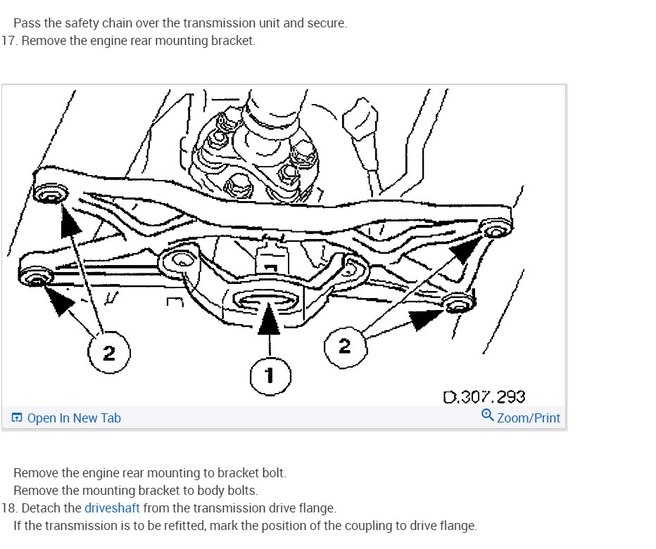

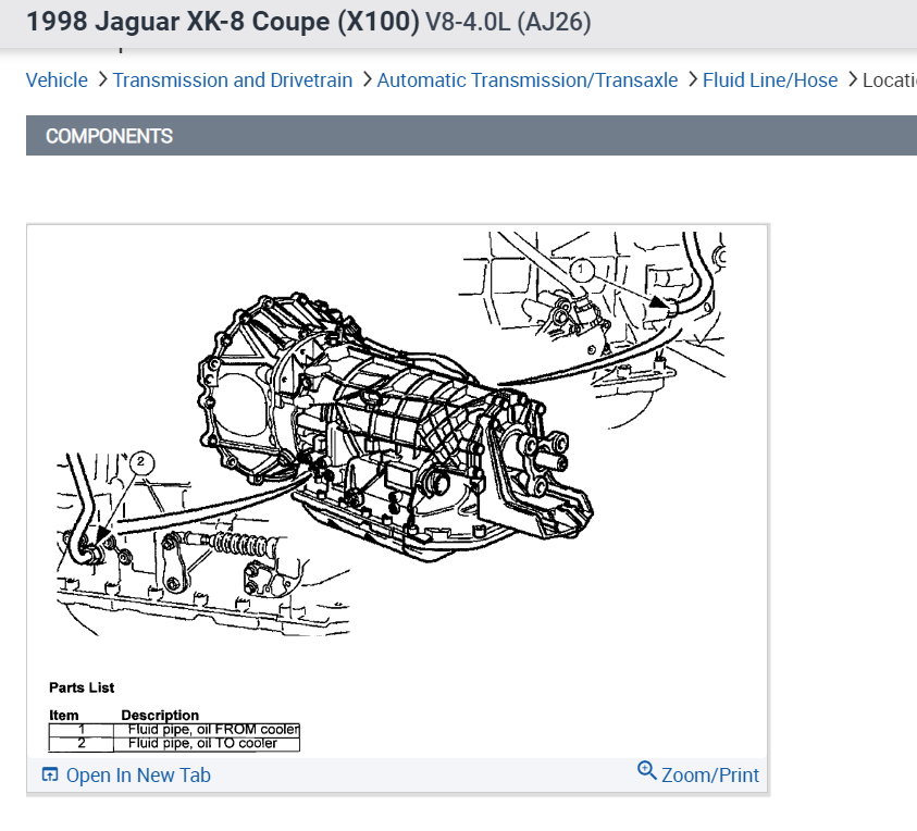

I would remove the rear transmission mount and lower the rear to help you gain access to the line, this should give you more room. Check out the images (below). Let us know what happens and please upload pictures or videos of the problem so we can see what's going on.

No, the mount won't do anything, the problem is getting the line from under the engine, it's already out of the transmission.

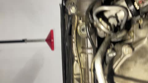

Video.
May 21, 2023 at 3:19 PM
Thanks for the video. Yep, that is not a lot of room to remove the line, you are on the right track by raising the engine up to gain access to the cooler line removal. Let me know how it goes.
