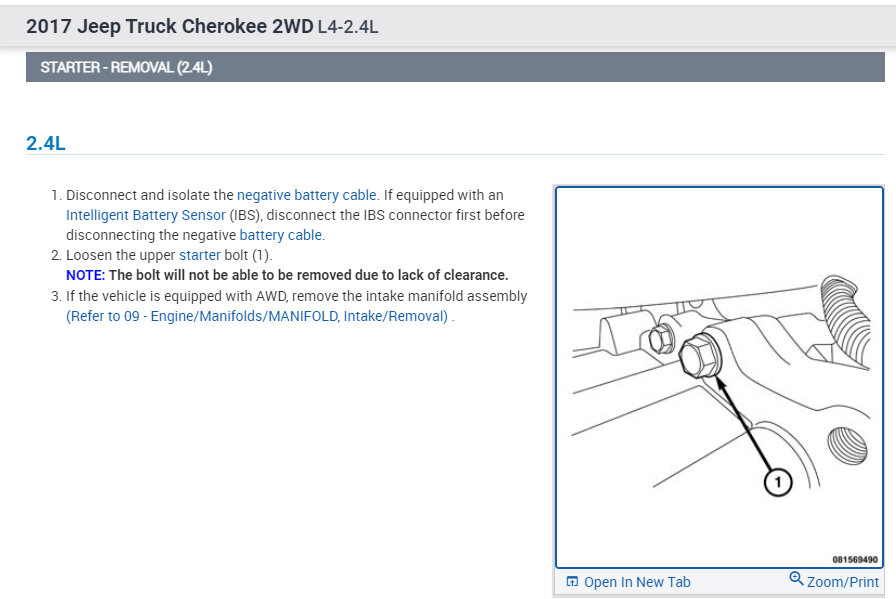

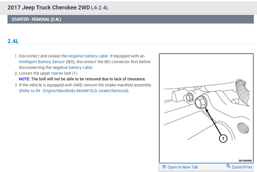

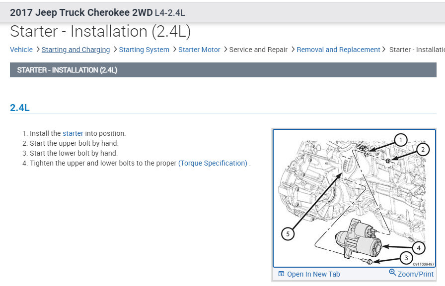

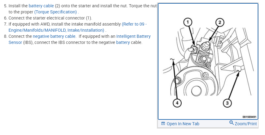

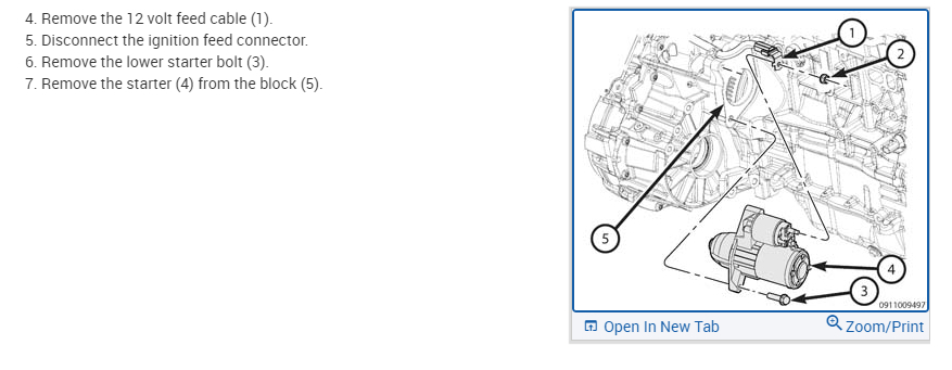

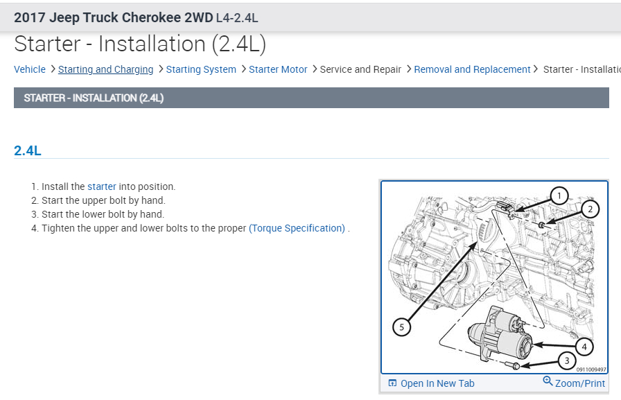

The starter motor on this is a little different because you will be able to loosen the upper bolt, but due to a clearance issue, you can't remove it. However, it will be disconnected, and the starter will come off.
Here is a link that explains in general how to replace one. You can use this as a guide.
If you look below, I attached the directions specific to this vehicle.
Let me know if this helps.
See pics below.
