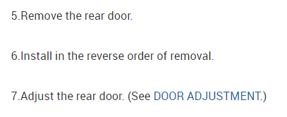

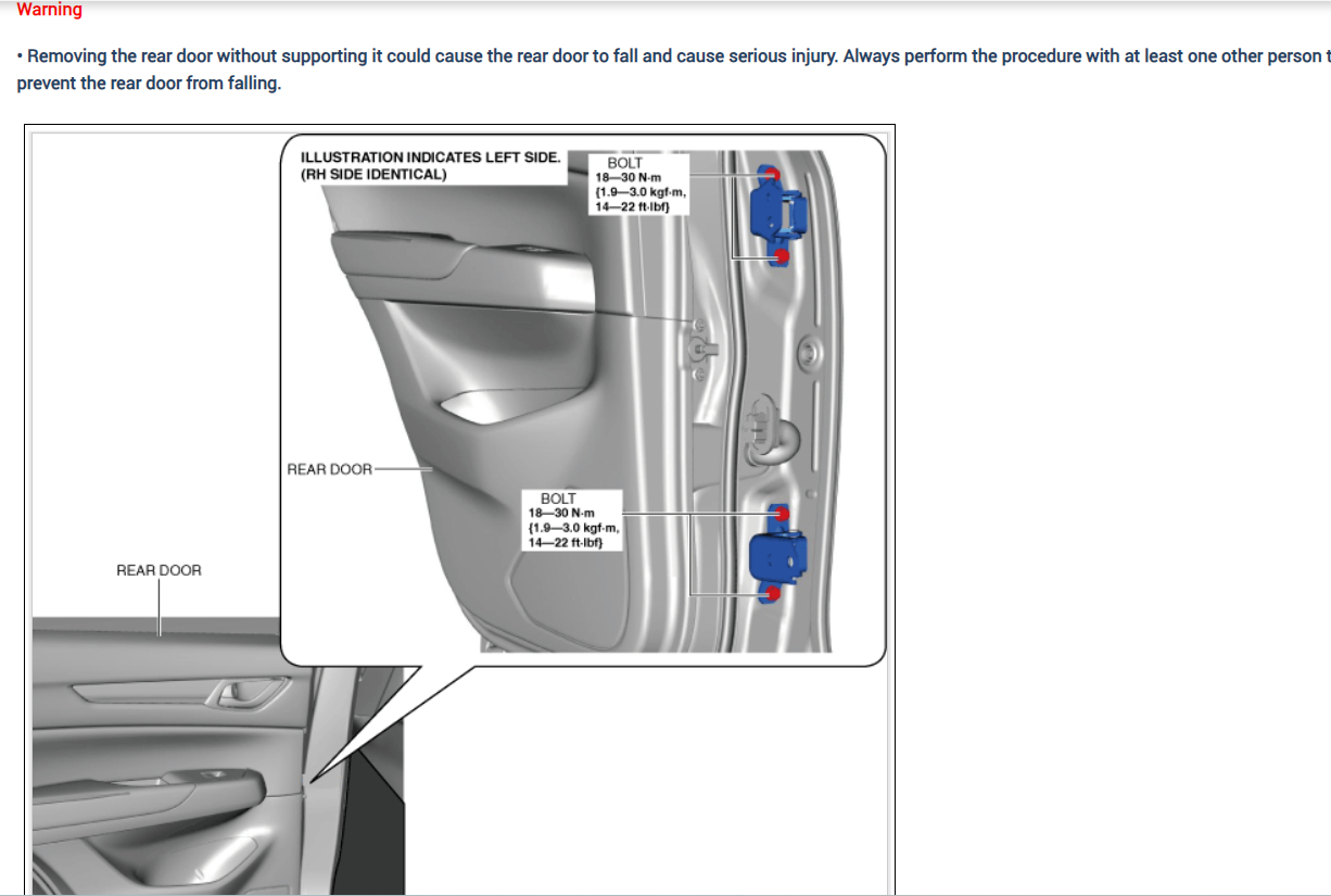

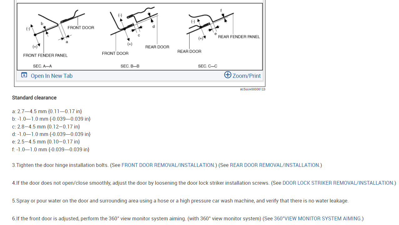

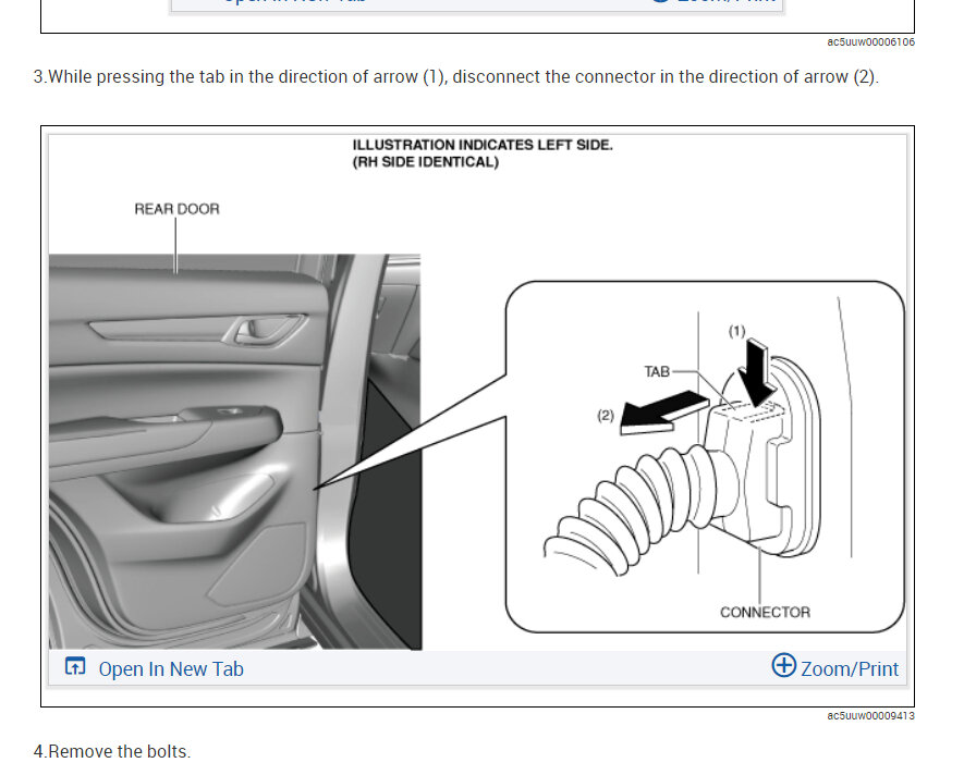

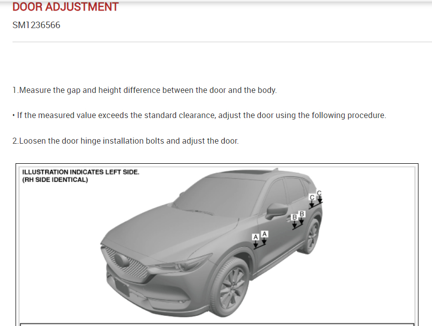

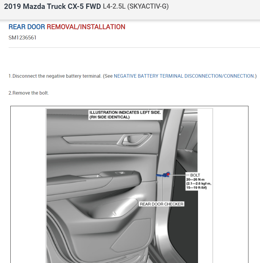

My rear driver's side door was destroyed in an accident. I have to replace it. What are the steps to removing and installing the new door? Also are there any reputable online sites that sell doors off junked cars? My local junkyard doesn't have any.
