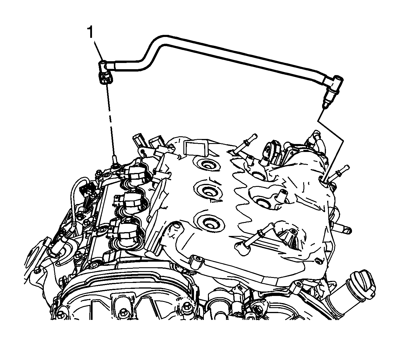

Steps to change PCV valve?
Mar 30, 2019 at 9:09 AM
Welcome to 2CarPros.
The PCV valve is located in the valve cover and simply pushes into a rubber grommet. If you look at picture 1, it shows the PCV hose which runs between the valve cover and the intake. Simply disconnect it at the Valve cover, remove the PCV, and replace it.
Let me know if this helps.
