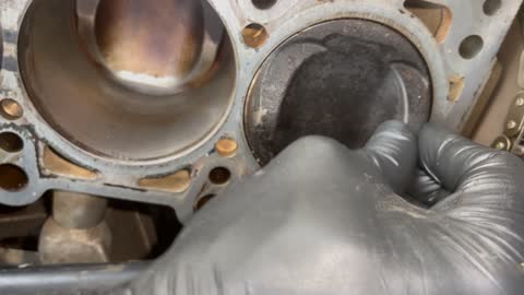

I can manually shake the piston, and I see it moving, while the other pistons are firmly in place.
May 22, 2024 at 8:55 AM
STEVE W.
  • 15,113 POSTS
How are you able to shake the piston? You have the engine out and apart or ?? That sounds like it could be more than just a bad piston. Can you take a video of it and post it here?
May 22, 2024 at 10:15 AM
ANDRIN ATEM
  • 393 POSTS
Sure, I had taken the head cylinder out, because I was replacing the head gasket and I noticed. But the engine runs well.
May 22, 2024 at 11:03 PM
STEVE W.
  • 15,113 POSTS
Okay, that's normal. The pistons start a bit loose in the bores and as soon as the engine starts they heat up and expand. If there were no room they would expand and lock in the bore. If the others don't move a bit in the bore the rings are likely carboned up and stuck in the grooves. As you have it that far apart I'd suggest doing a refresh on it. Pull the engine out the rest of the way. Pull the oil pan and remove the crankshaft and inspect all those bearings (or just replace them. While it's apart remove the old piston rings, install new rings and use a simple hone it each bore just to break the finish on the cylinder walls. Clean up the residue and put it back together. Reseal the cylinder heads and lap in the valves and you would have a better engine. Because of the lack of any damage the cylinder head shouldn't be a problem. Now if you wanted to you could actually go the full rebuild route and not just a refresh. That would involve removing the engine, stripping the block and sending it and the crankshaft to a machine shop and having the cylinders bored to the first oversize that has pistons available, line honing the crankshaft saddles and having the connecting rods resized and all new pistons, rings and bearings fitted. Now do the heads and you would have a "new" engine.

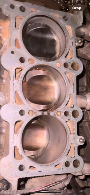

Thank you, this started with a leakage on the water-cooling system, then resulted in overheating and a blown gasket on cylinder 4 and 5, Can I use also a sand paper with a flat table surface for cleaning and aligning any bends on the top?
I will send you an image of the blown gasket position.

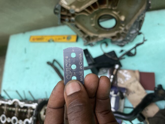

Thank you very much for this information. Is it possible to get the specifications for resurfacing this block. I actually checked using a straightedge and a feeler gauge, both head cylinders are all flat, using the 5 steps method. But rather the block is sung in between cylinder 4 and 5. So rather it’s the block which needs resurfacing. I will send you an image.
May 25, 2024 at 9:53 AM
ANDRIN ATEM
  • 393 POSTS
That black spot right there is the block where I had the failed gasket, using a feeler gauge and a straightedge, I noticed it’s sunk in just about half a millimeter, I think. This blade could go through it with very little resistance.
May 25, 2024 at 10:03 AM
STEVE W.
  • 15,113 POSTS
That isn't a good thing. A good machine shop would be able to machine it a bit, then weld up the low areas and then machine it back flat. Or it might be possible to deck the block and get it flat but that would take measuring the pistons to see how close they are to hitting the cylinder head. If they are too close material removal could cause problems.

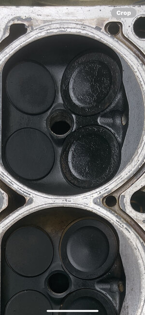

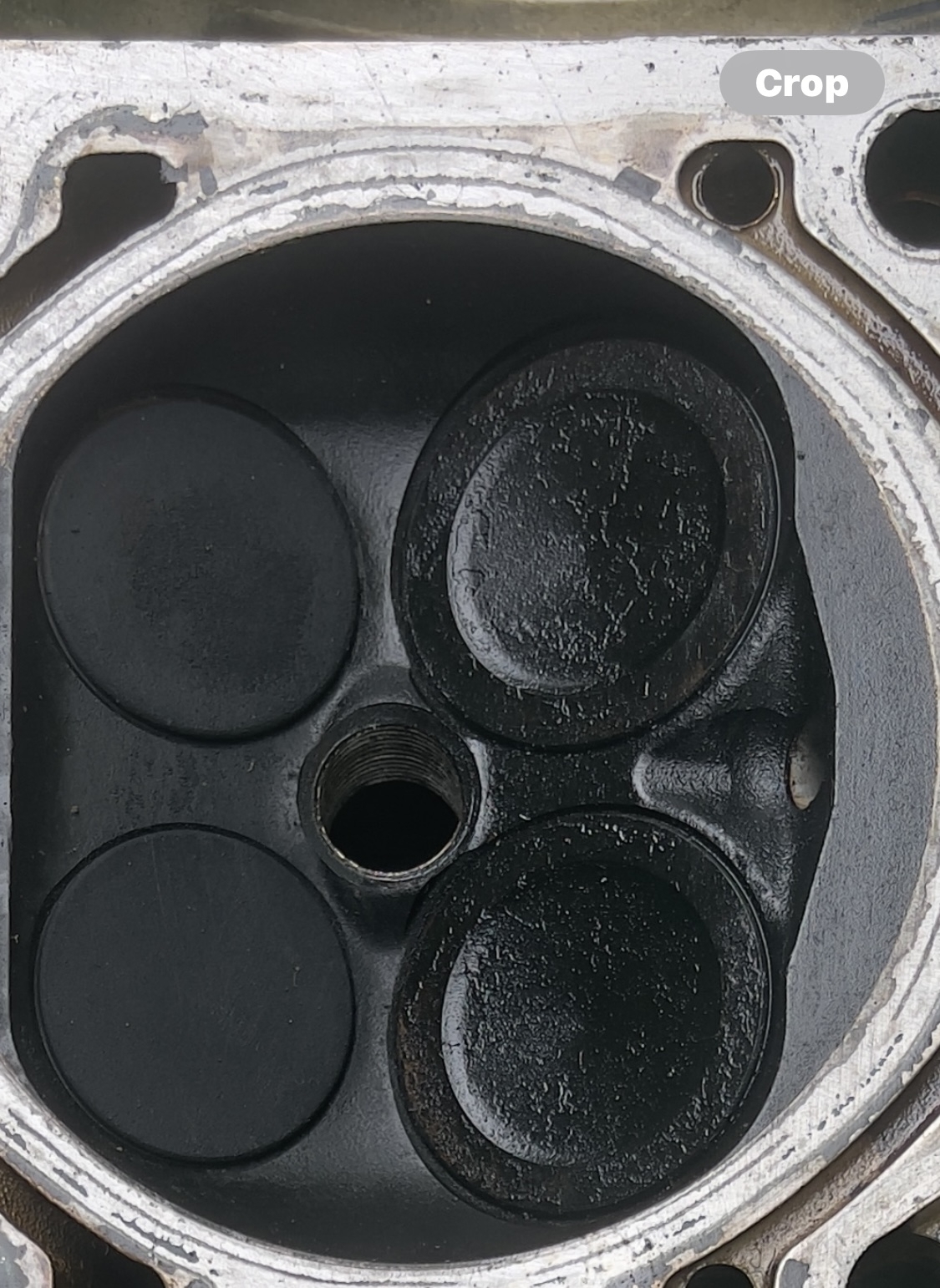

One last question for now. Please advise me on this valves on the head cylinder, I got two which looks a little bit oily. Let me upload the image.
May 25, 2024 at 3:05 PM
ANDRIN ATEM
  • 393 POSTS
Hahahahahahahaha, thanks!
ANDRIN ATEM
  • 393 POSTS
I noticed it looking that way when I took out the top, but I have turn the camshafts to inspect its opening and closing, it opens well and closing needly.I am truly not a professional mechanic, but I am a professional in cars electronics and electrical, maybe about 60% in mechanics, but I am a fast learner..
May 25, 2024 at 3:08 PM
STEVE W.
  • 15,113 POSTS
I would just clean them up. That could be oil or coolant hard to tell which. But if you go through the heads and refresh them it shouldn't be an issue when you put the engine back together.
