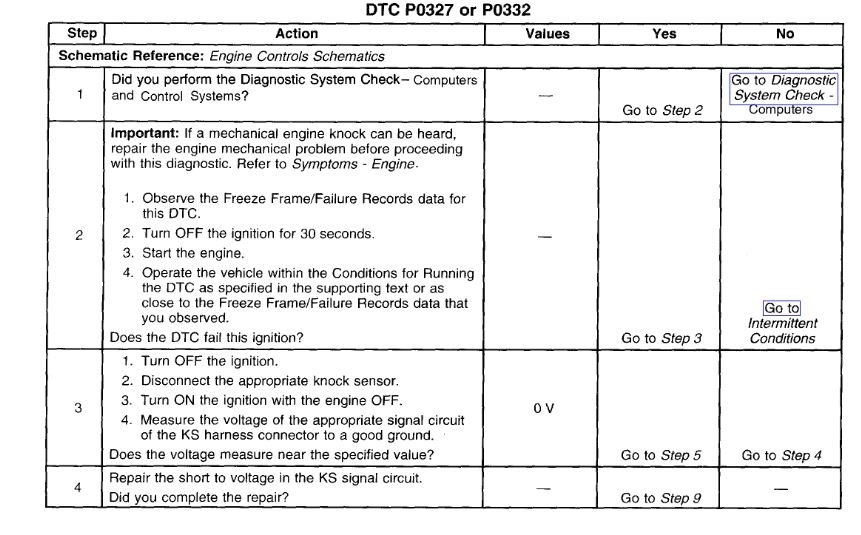

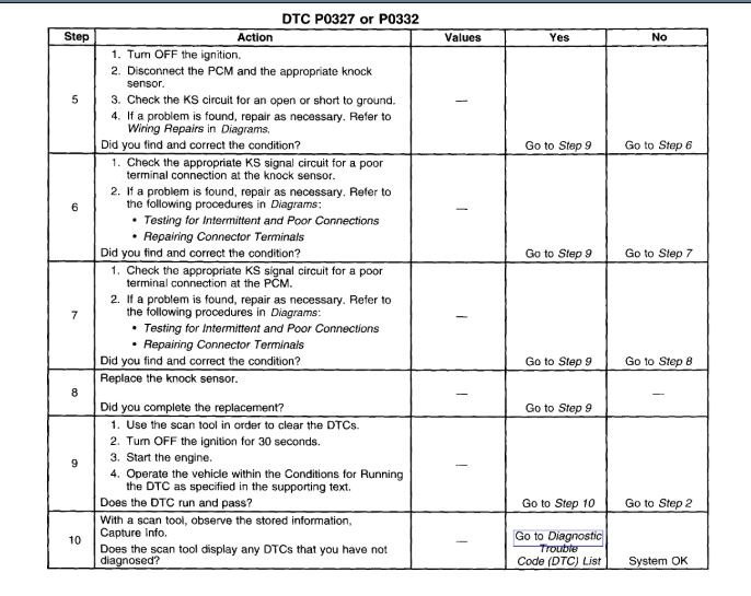

I attached the procedure and some pictures for you. I also attached a flow chart for the code to be sure it is the sensor. Codes rarely identify bad parts, just failed systems.
CIRCUIT DESCRIPTION
The Knock Sensors (KS) produce an IAC signal under all engine operating conditions. The Powertrain Control Module (PCM) calculates the average voltage range of each KS signal. If the KS system is operating normally, the PCM should monitor the KS voltage varying above and below a calculated average voltage. If the PCM detects a KS 1 signal voltage or a KS 2 voltage signal within the calculated average voltage range, a DTC will be set. A DTC P0327 refers to bank 1 knock sensor. A DTC P0332 refers to bank 2 knock sensor.

CONDITIONS FOR SETTING THE DTC
The PCM detects a knock sensor 1 or knock sensor 2 voltage within the calculated average voltage range.

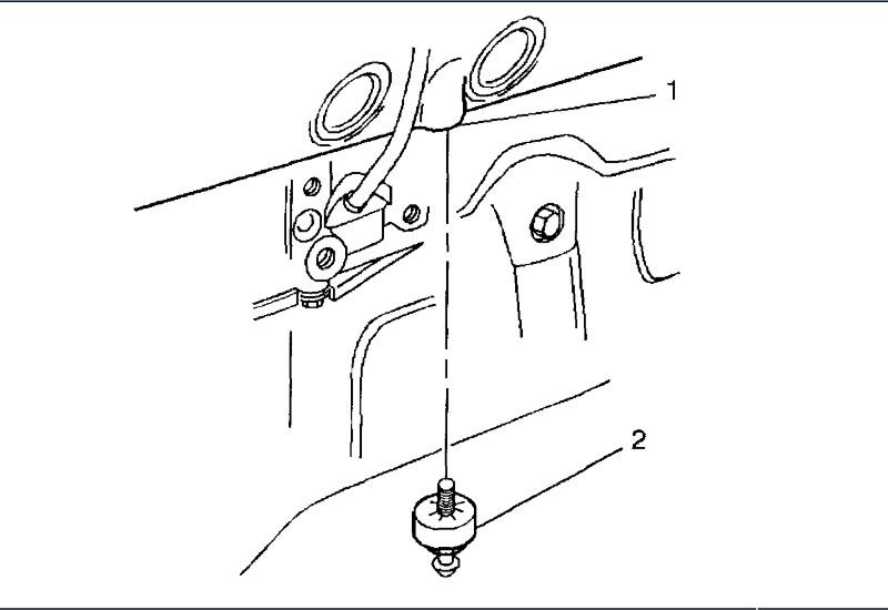

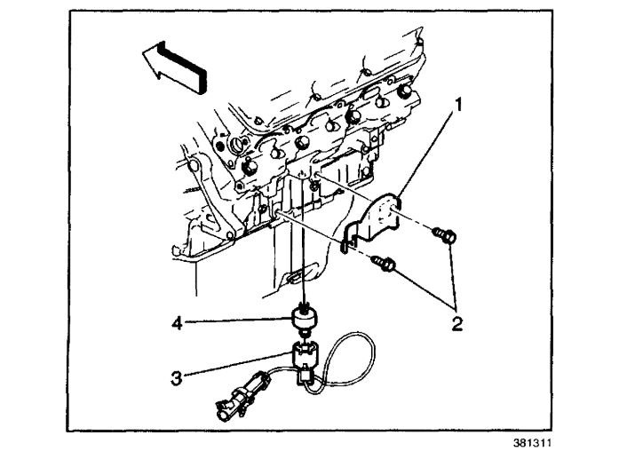

REMOVAL PROCEDURE
CAUTION: Refer to Knock Sensor Service Caution in Service Precautions.
1. Turn OFF the ignition.
2. Raise the vehicle. Refer to Lifting and Jacking the Vehicle.
3. Remove the bolts from the splash shield.
4. Drain the cooling system. Refer to Draining and Filling Cooling System in Cooling System.
5. Remove the bolts (2) from the knock sensor heat shield (1) located under the freeze plug or block heater if equipped.
6. Disconnect the knock sensor wiring harness connector (3) from the knock sensor (4).
7. Remove the knock sensor (2) from the engine block (1).
INSTALLATION PROCEDURE
NOTE: Refer to Fastener Notice Fastener Notice in Service Precautions.
IMPORTANT: Do Not apply thread sealant to sensor threads. The sensor is coated at factory and applying additional sealant will affect the sensor's ability to detect detonation.
1. Install the knock sensor (2) into the engine block (1).
Tighten
Tighten the knock sensor to 19 N.m (14 lb ft).
2. Install the knock sensor heat shield
Tighten
Tighten the bolts to 60 N.m (44 lb ft).
3. Connect the knock sensor electrical connector to the knock sensor.
4. Install the splash shield.
5. Lower the vehicle.
6. Fill the cooling system. Refer to Draining and Filling Cooling System in Cooling System.
