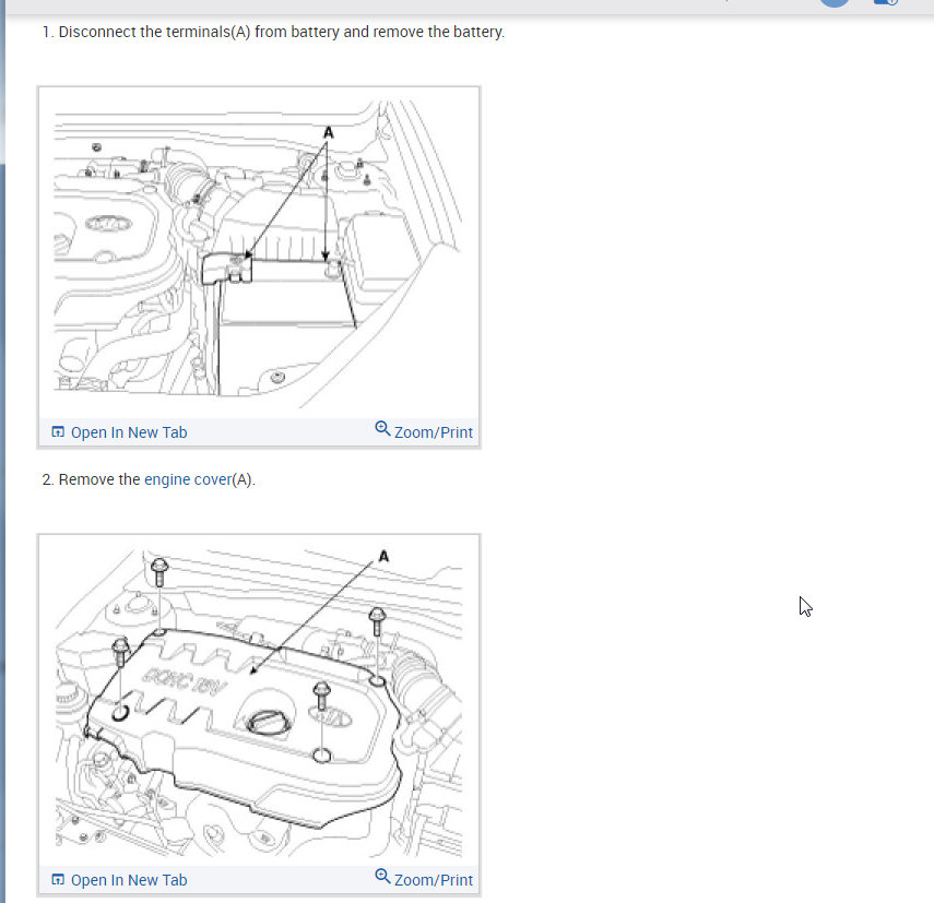

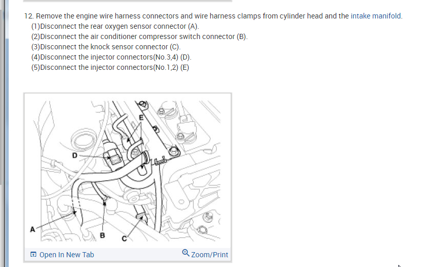

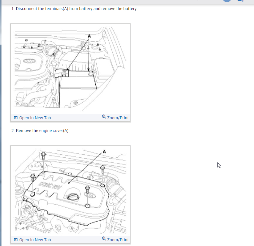

I want to replace the fuel injectors. I don't know how to get to them properly, or what to remove and in what order.
Dec 29, 2020 at 9:05 PM
Surprisingly the manual does not list a specific process for the injectors but I was able to piece this together from the process on disassembling the engine.
Also, here is a guide that will help as well as this is a process that is pretty standard:
https://www.2carpros.com/articles/how-to-replace-a-fuel-injector
Below is the attached information from the manual. It appears your injectors are pretty accessible so you should be able to see them when you remove the engine cover.
