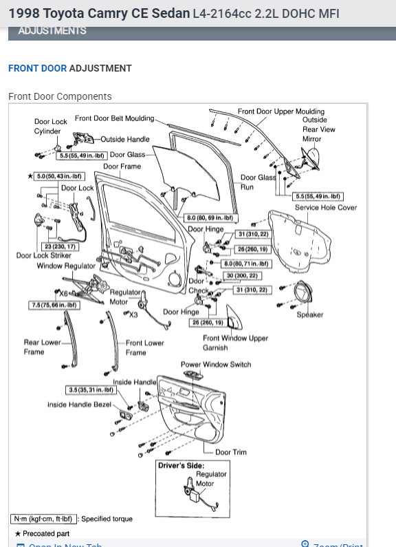

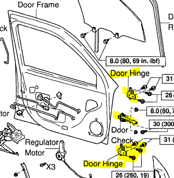

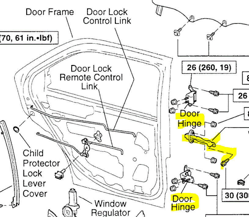

See pics below. Pic 1 is front door. Pic 2 shows the rear door. I highlighted the bolts involved.
