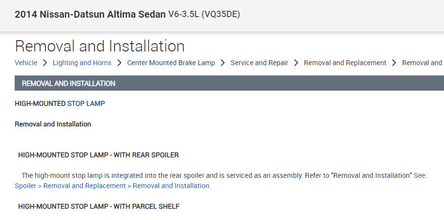

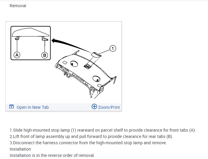

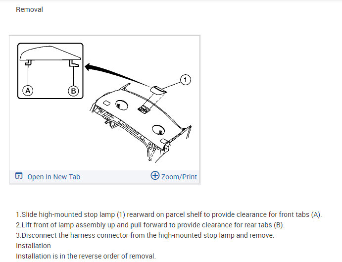

Hi:
I attached the directions below for removing the light assembly. Is that what you are referring to? If it isn't, could you upload a few pictures of the part?
