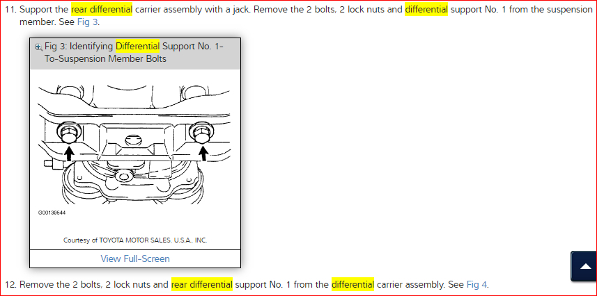

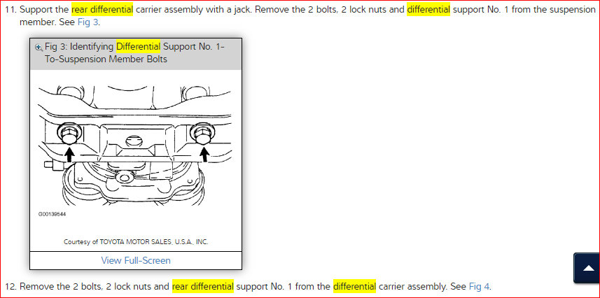

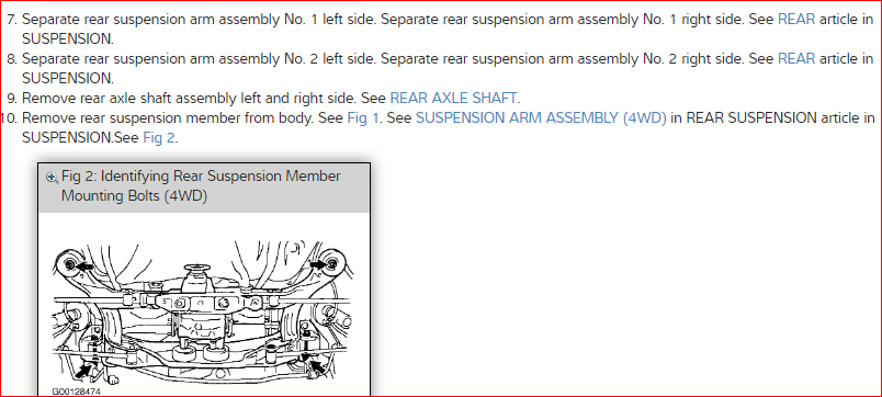

I have got a whining noise on the road, not associated with engine or tires. Tire shop says it is the differential. I am considering replacing the differential with a used one, to get another year or two out of it.
Q) Do I need to remove the wheels? Or will the differential just drop out after I remove bolts to axles, drive shaft, and frame?
Thanks for your help!
Sep 20, 2018 at 5:37 PM
DANNY L
  • 5,648 POSTS

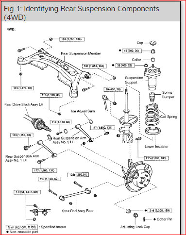

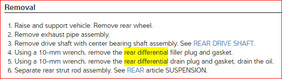

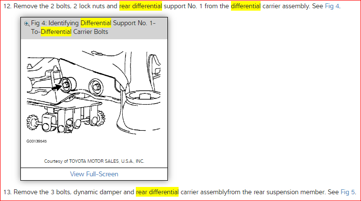

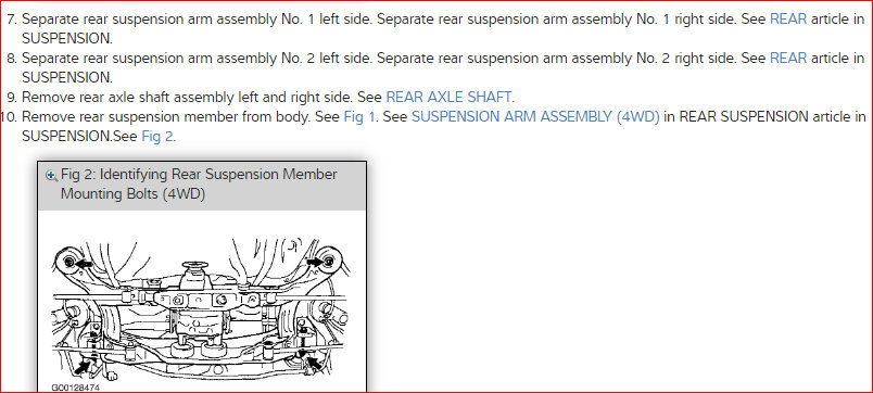

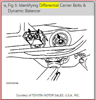

Hello, I am Danny.
I have attached a step-by-step instructions on how to remove. Hope this helps and feel free to ask any questions. Thanks for using 2CarPros.
Danny-
https://www.2carpros.com/articles/how-to-remove-a-drive-shaft
