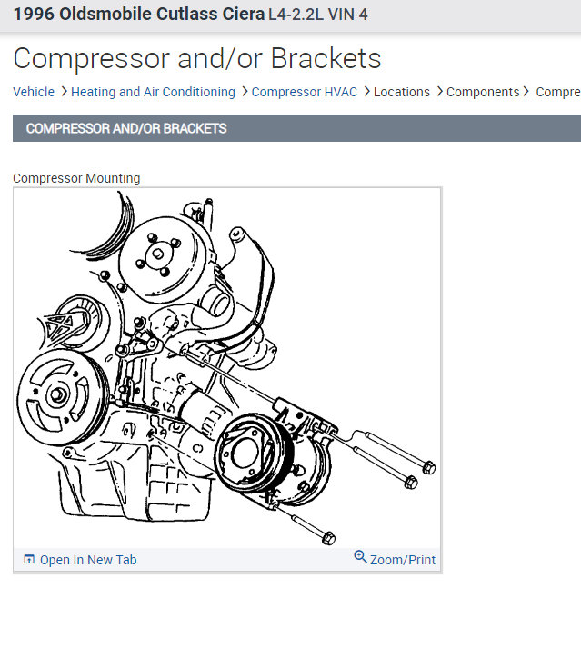

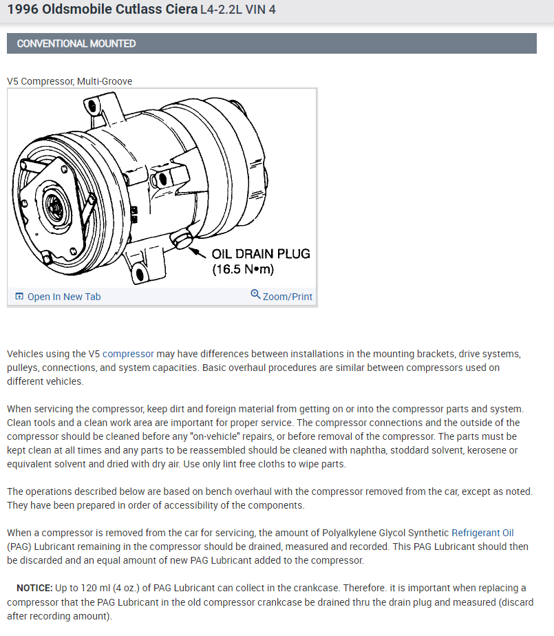

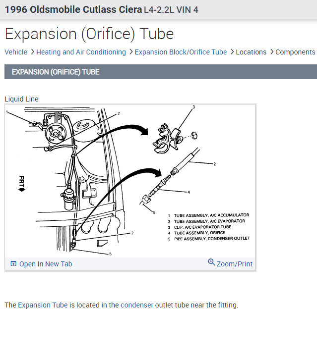

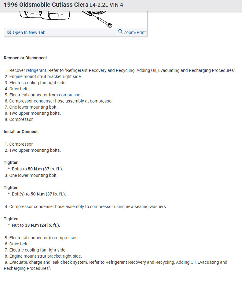

it makes a loud noise when i turn the car on and hot air coming from a/c when i turn on a/c. mechanic said that the a/c compressor needs to be replaced before it tears up the belt. and the loud noise continues even when i am driving the car and sometimes it does not make the loud noise. could you tell me the steps on how to take out the old compressor and put in the new one and how to put r134 into it to make it have cold air again. thank you.
