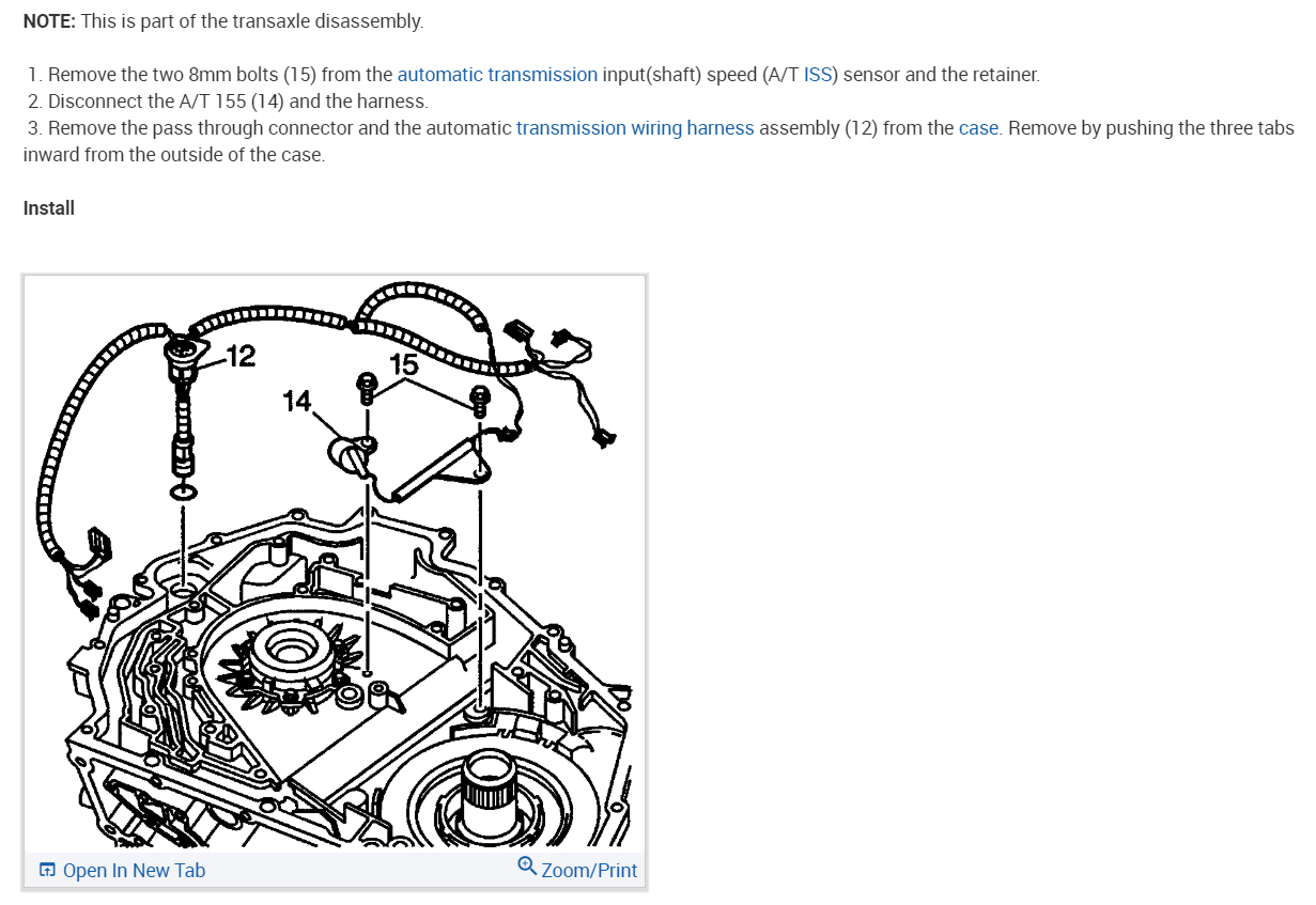

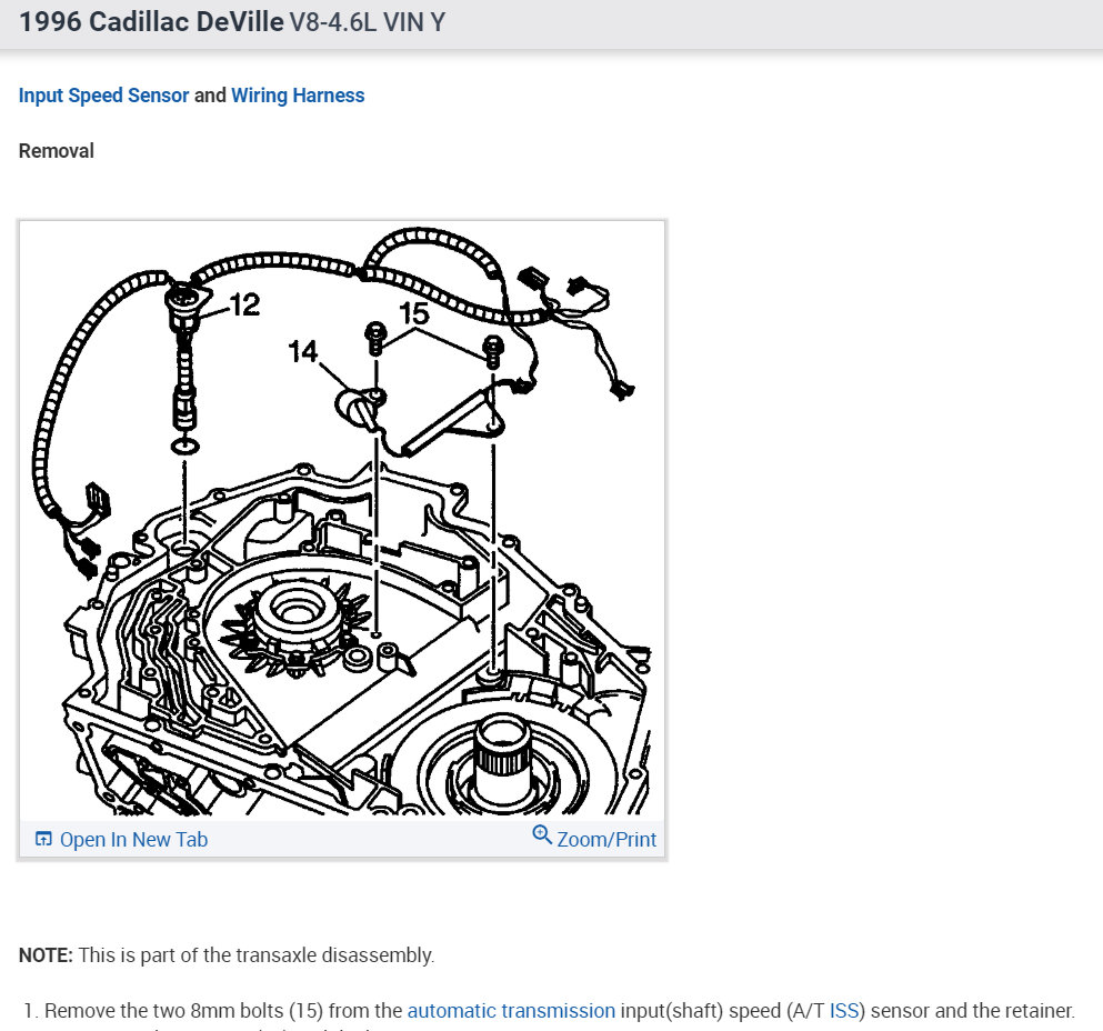

input turbine input sensor. How to replace input turbine speed sensor?
Aug 6, 2019 at 4:36 PM
CERTIFIED EXPERT
53,854 POSTS
The input speed sensor is located inside the transmission. here are instructions on how to replace it in the diagrams below. Please let us know if you need anything else to get the problem fixed.
