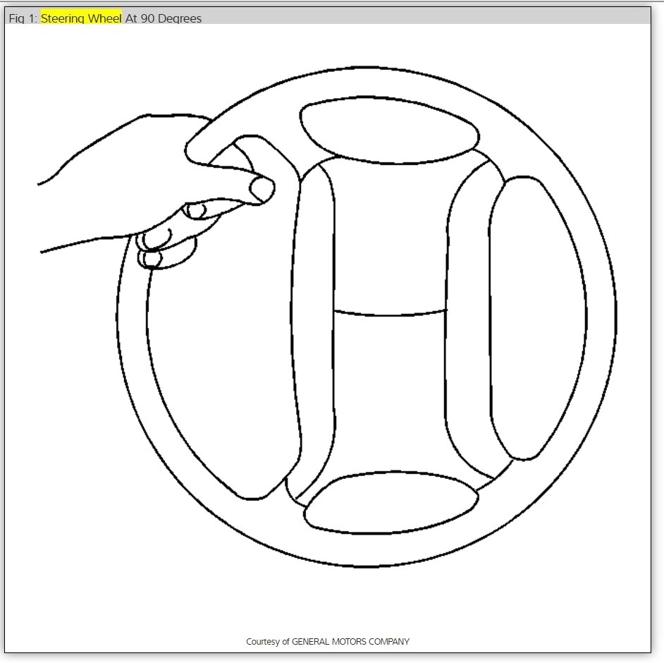

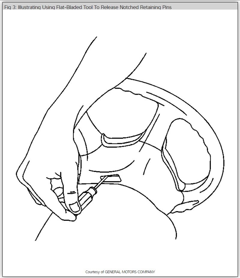

I want to replace ignition the steering wheel is stubborn.
Jul 4, 2018 at 1:50 AM
CERTIFIED EXPERT
53,855 POSTS

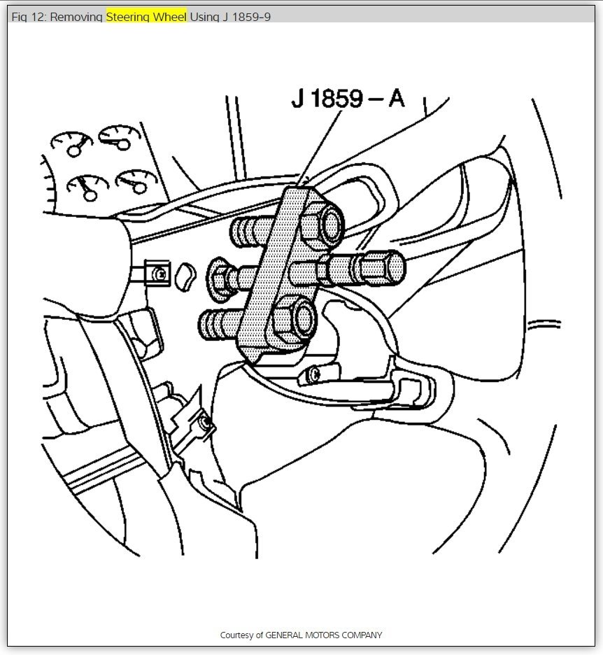

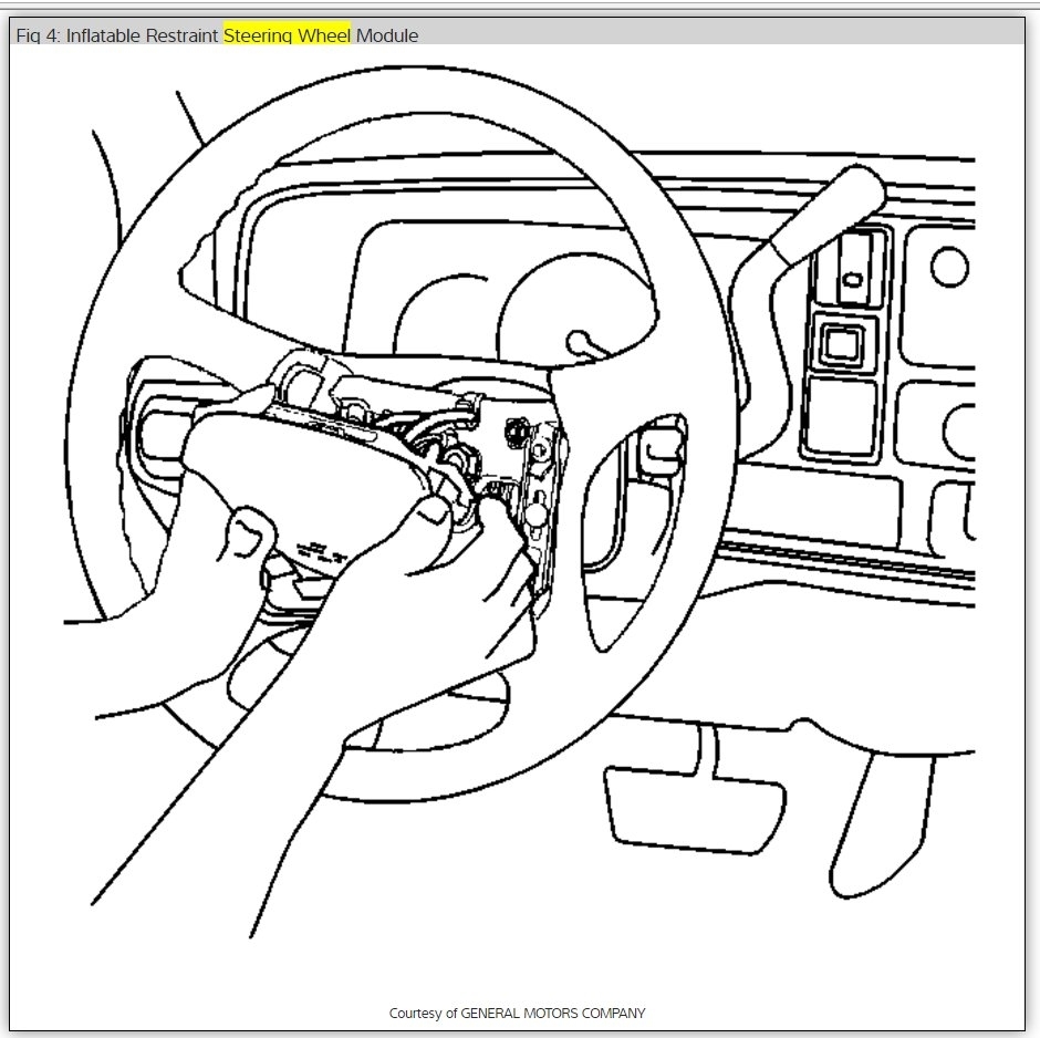

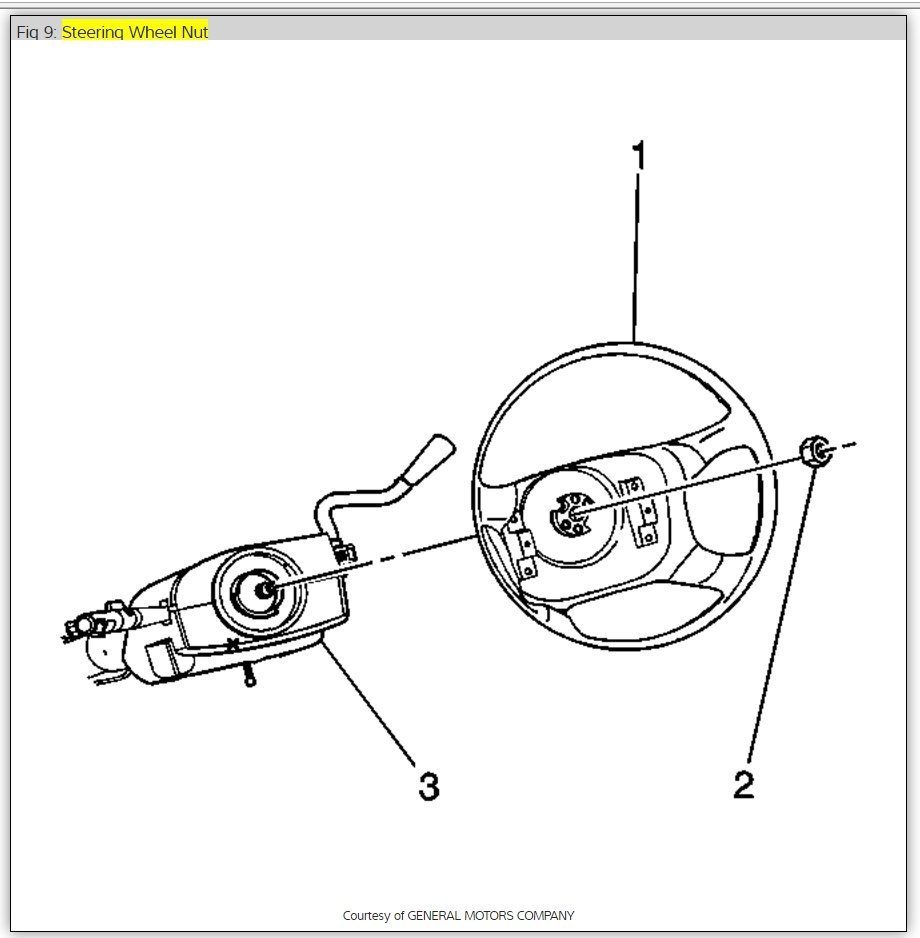

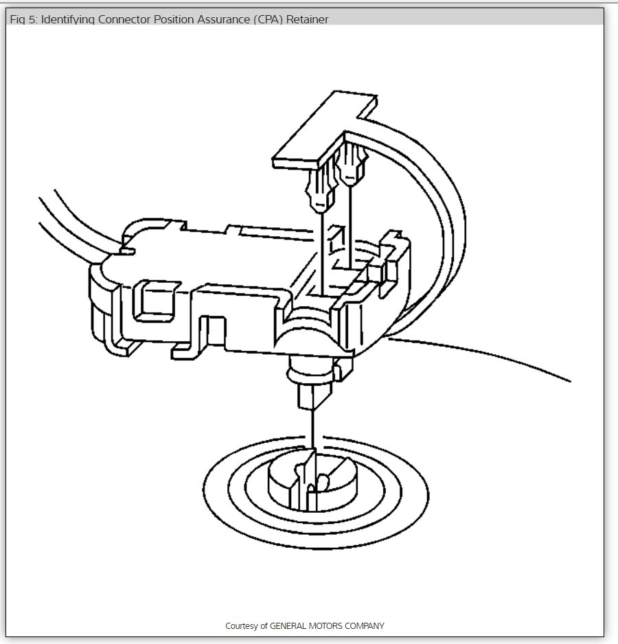

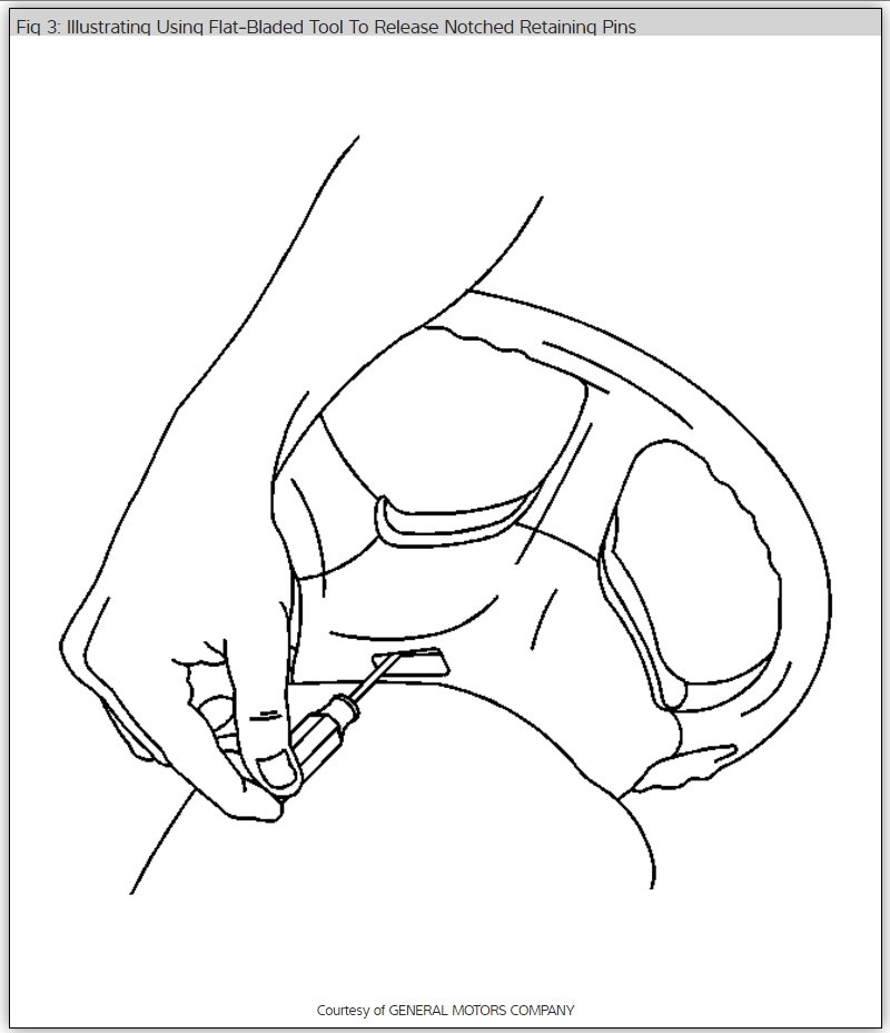

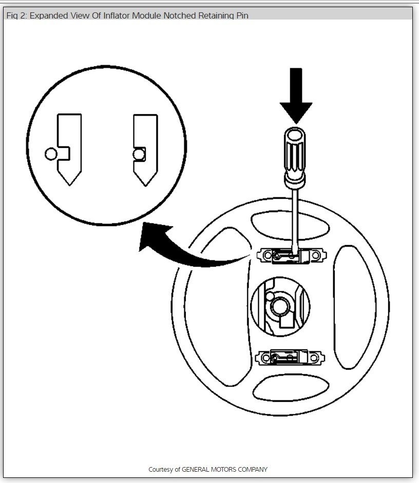

Here is a guide to help you remove the steering wheel and diagrams below to help you as well:
https://www.2carpros.com/articles/steering-wheel-removal
