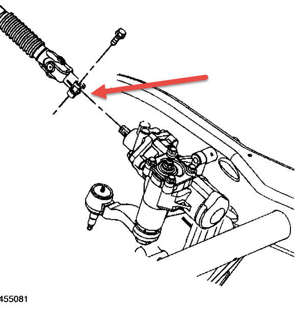

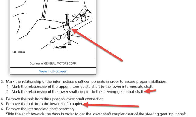

how do i remove gear box from shaft to take it i heald that it is one screw where is it located so i can pull the steer box from the shaft thanks

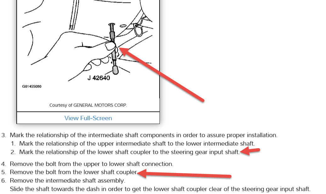

see pics for removal. steering shaft bolt torque is 35 ft. lbs. and stering BOX torque is 110 ft. lbs.
