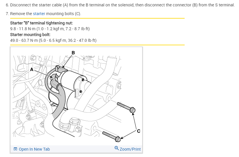

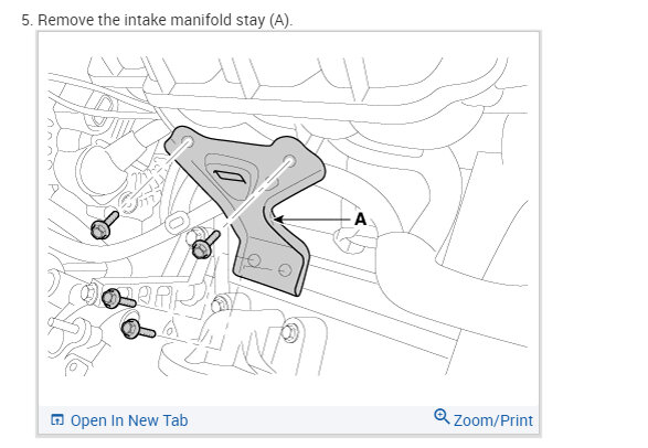

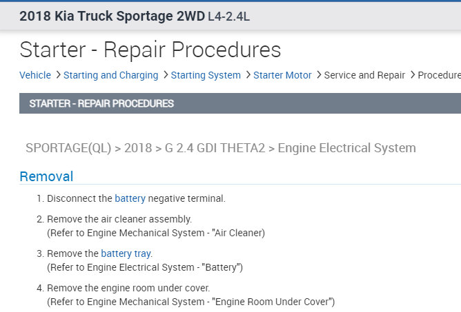

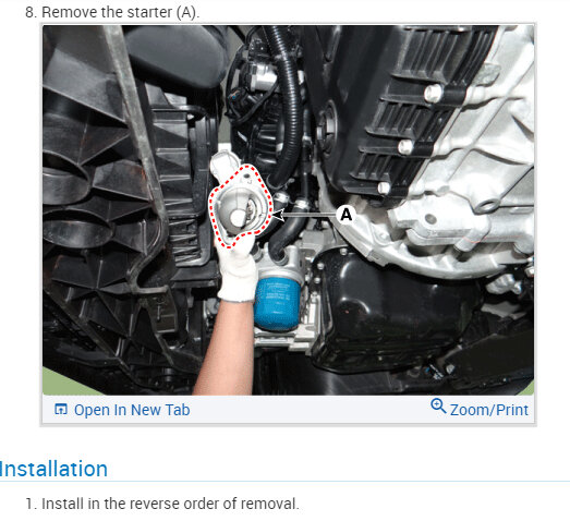

If you look below, I attached the directions from my manual specific to this vehicle. Take a look through them and let me know if you have any questions.
Take care and let me know if this helps.
See pics below.
