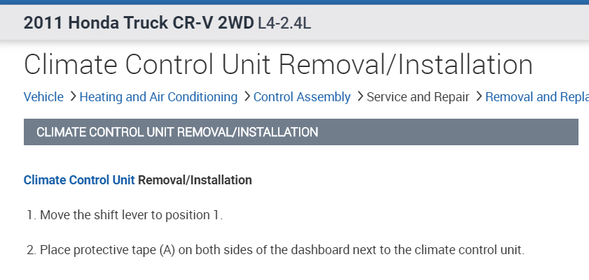

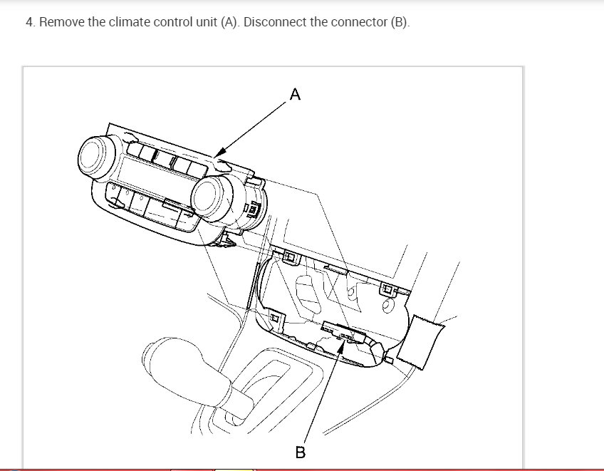

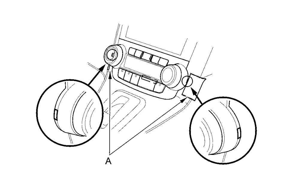

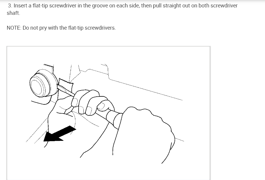

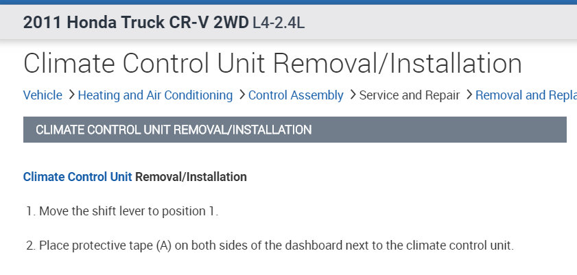

Climate control module is physically broken. I need to know how to go about removing/replacing the control module.
Oct 20, 2019 at 10:40 AM
SCGRANTURISMO
  • 4,897 POSTS

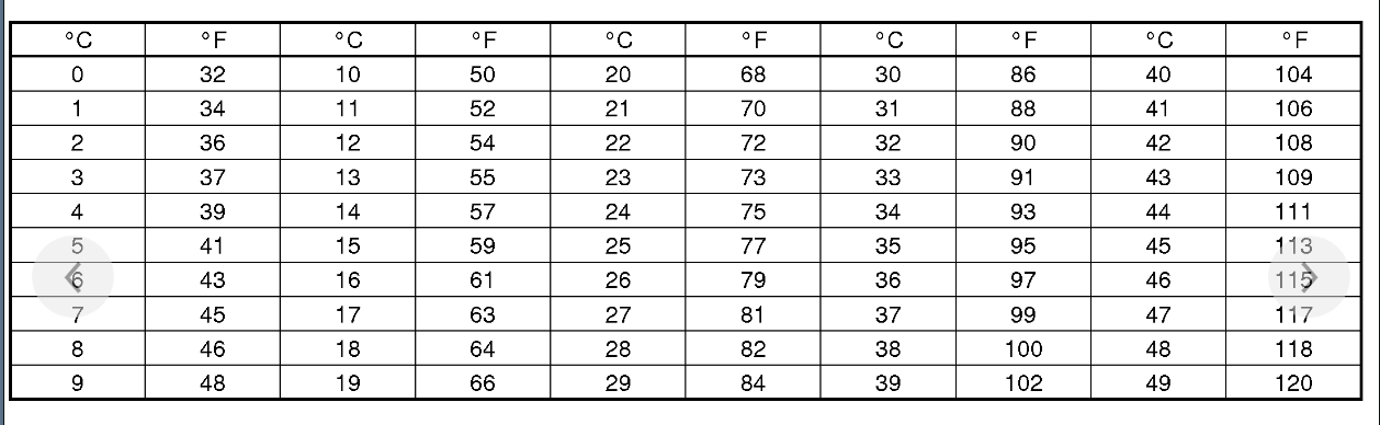

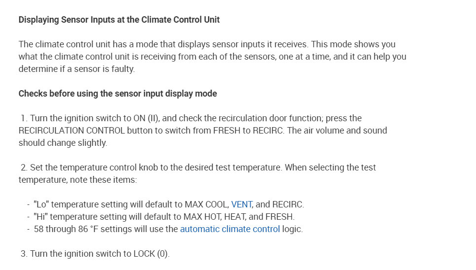

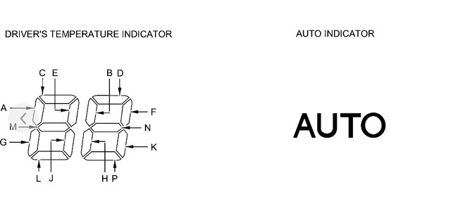

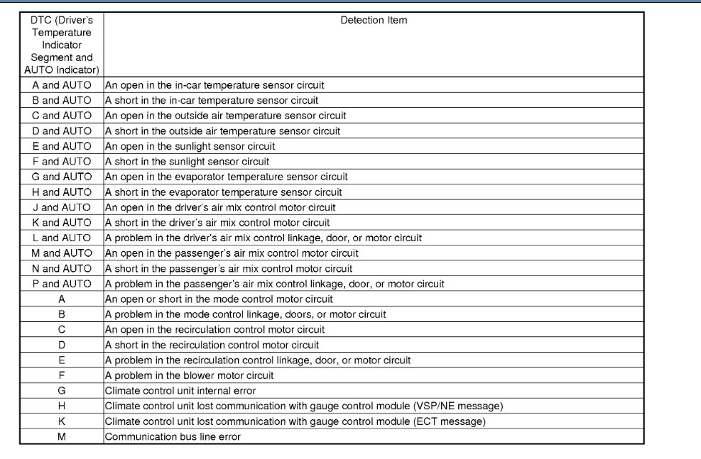

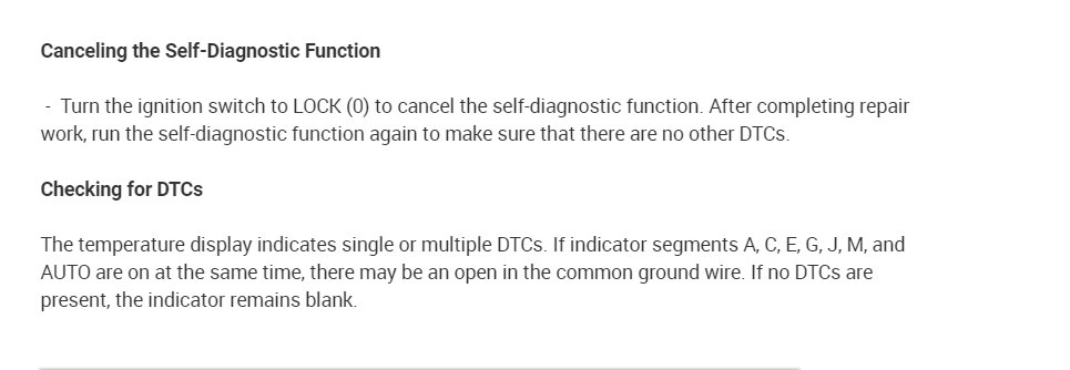

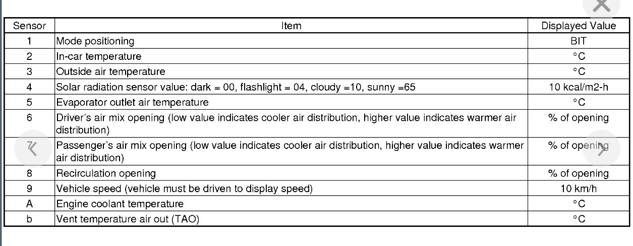

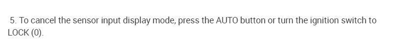

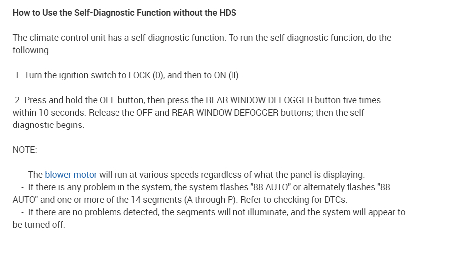

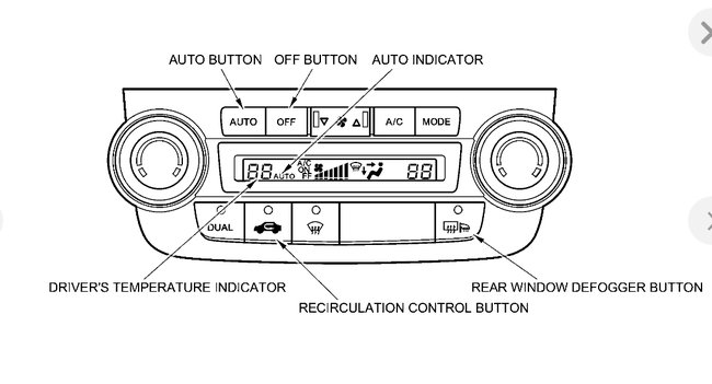

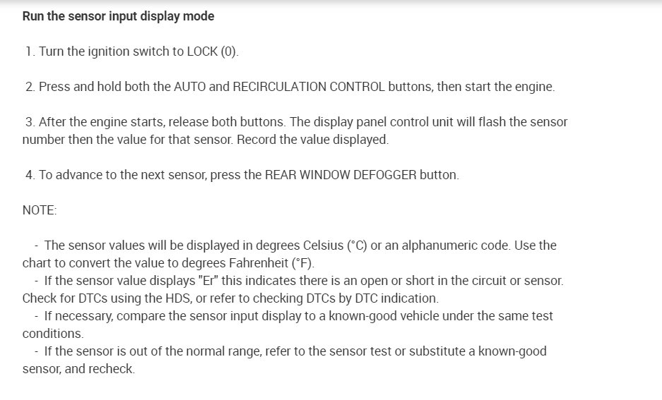

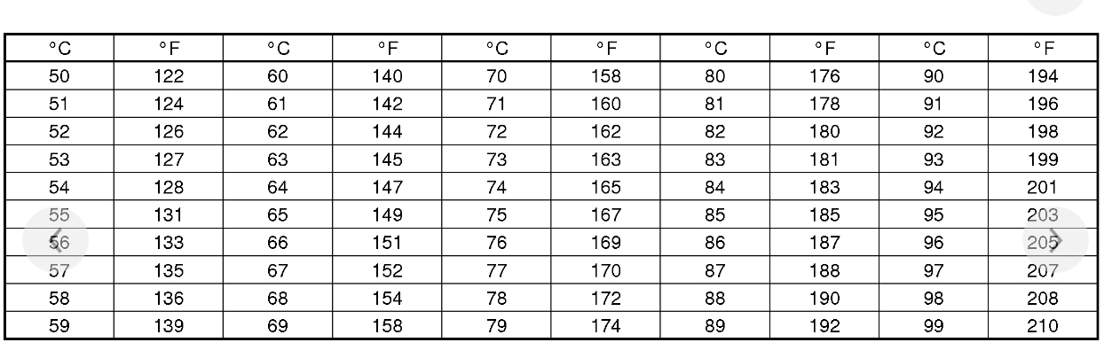

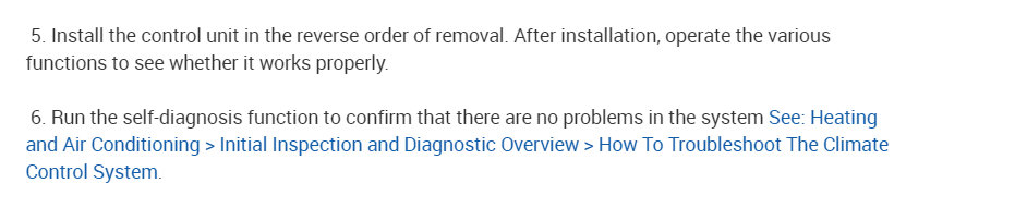

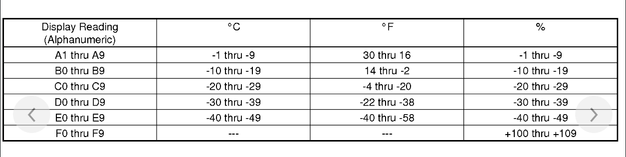

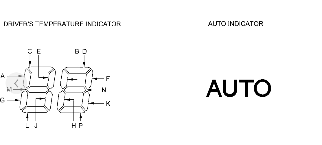

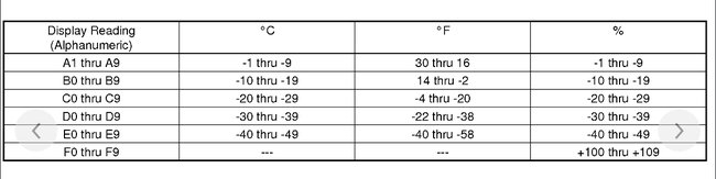

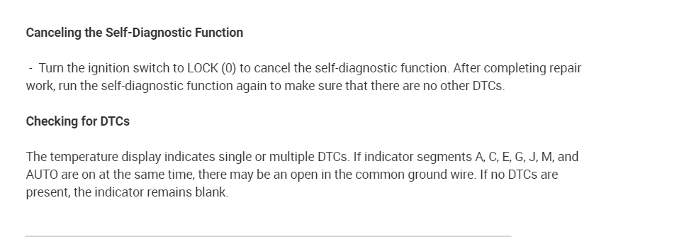

I have included the information that you requested in the diagrams down below. Please get back to us with how everything turns out and I hope this helps.
Thanks,
Alex
