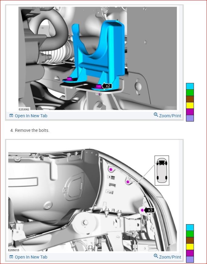

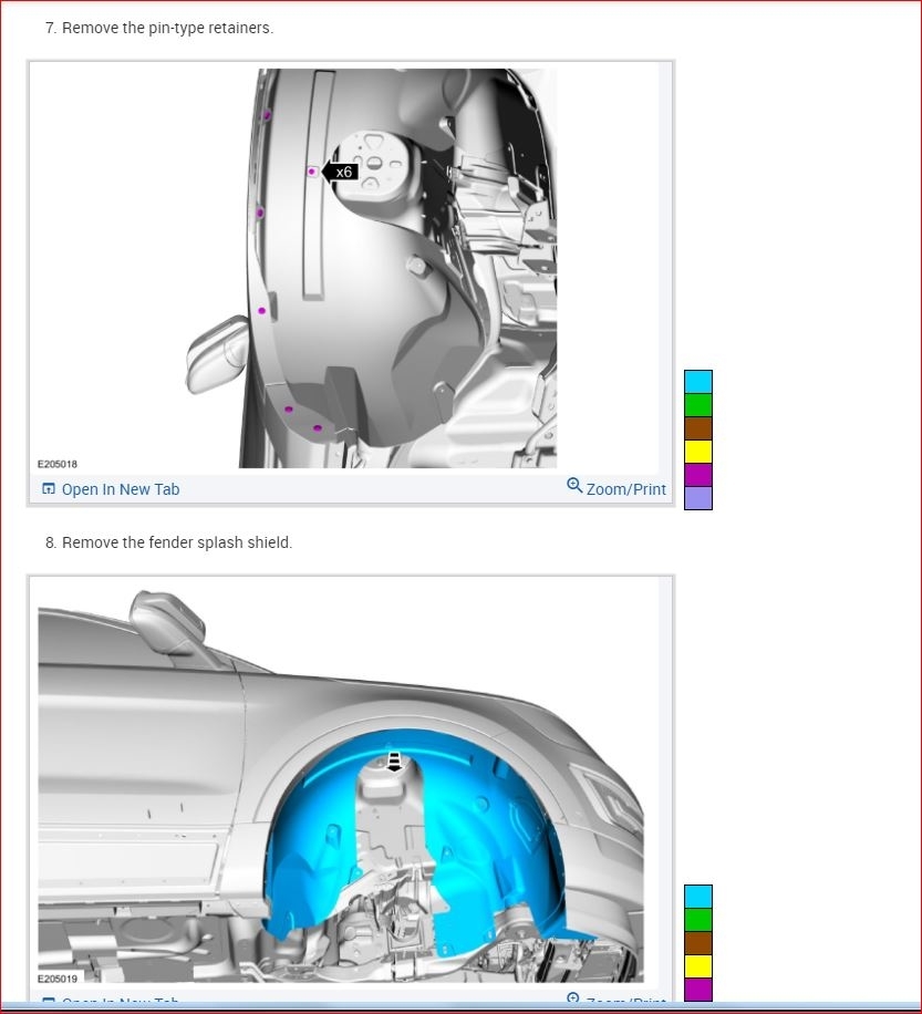

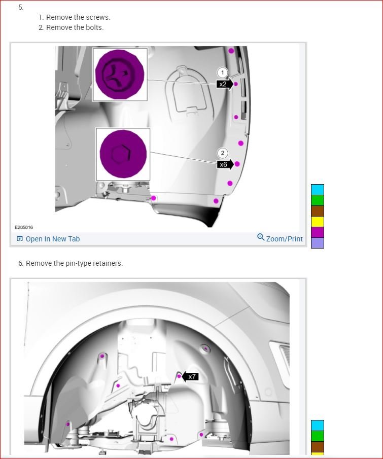

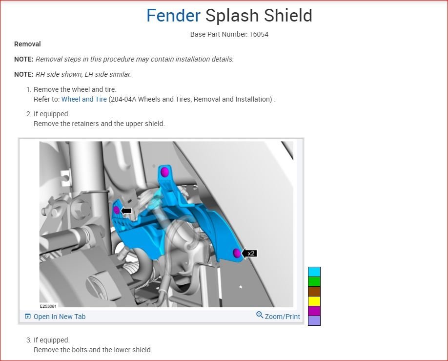

This is the procedure for the right front but the process is the same side to side. They just pictured the passenger side.
Please let me know if you need anything else. Thanks
