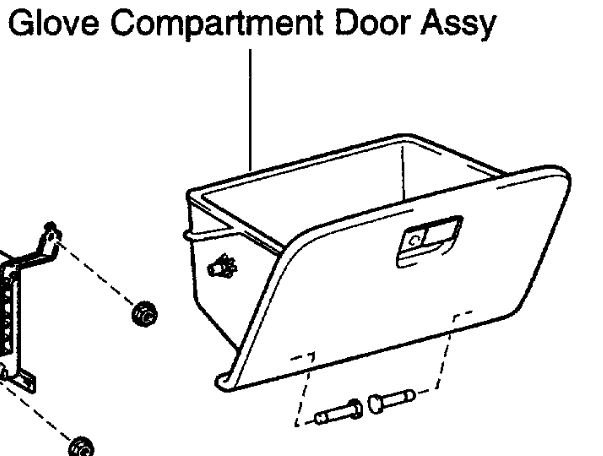

How to remove glove box for access to evaporator assembly
2003 TOYOTA HIGHLANDER
270,000 MILES • 6 CYL • 2WD • AUTOMATIC
PAKAWALA
Manual temperature control doesn’t work for either A/C or heat, only blows cabin air at ambient temperature.
Apr 21, 2019 at 8:01 AM
Welcome to 2CarPros.
I attached a picture showing where the two hinge bolts are located. To fully open the door, you simply need to press in on the sides where the plastic stops prevents it from fully opening it.
Let me know if this helps.
