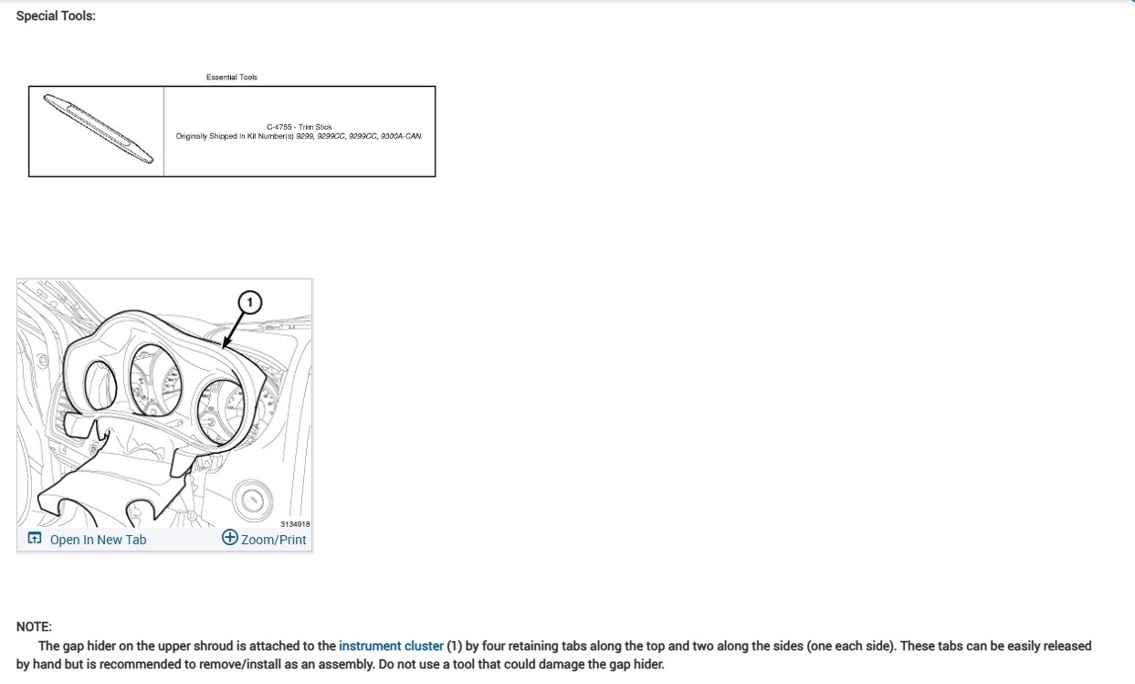

need to remove it for repair. I don't see how the top part panel can be removed.
May 26, 2024 at 6:34 AM
AL514
  • 5,464 POSTS

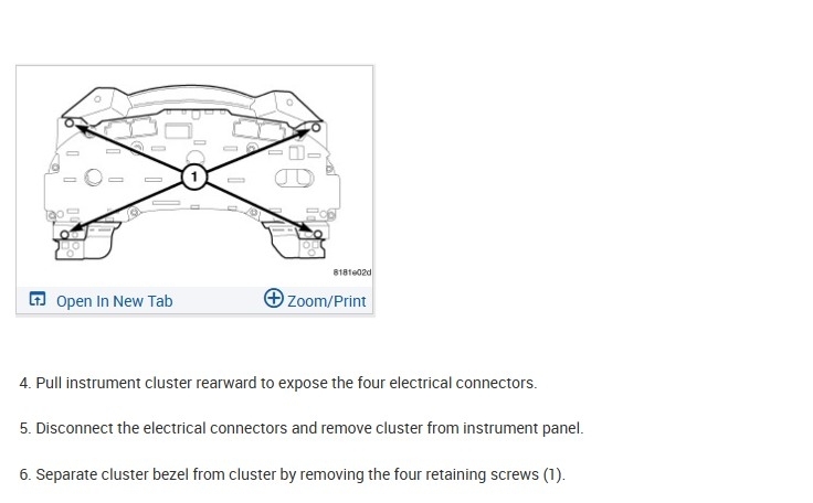

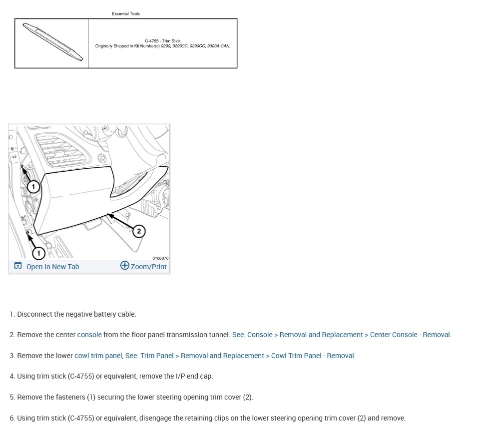

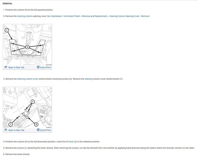

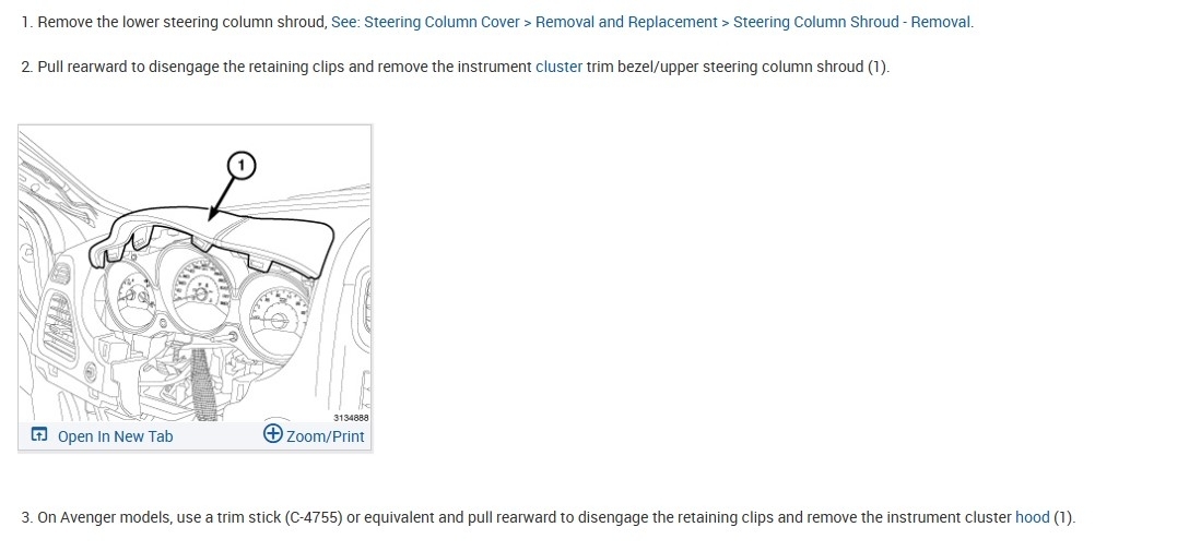

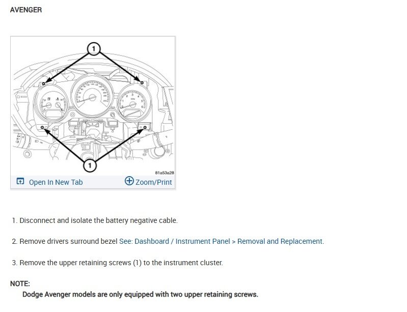

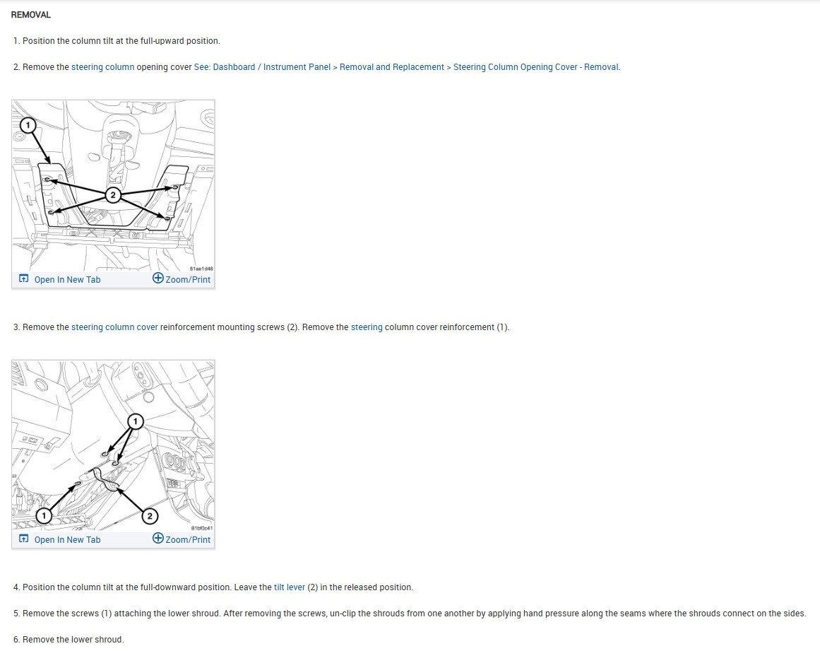

Hello again, it's quite the process, the covering around the steering column has to come out first, I'll post each step, but disconnect the negative battery cable and isolate it if not already done and let the airbags discharge the capacitors in the meantime.
May 26, 2024 at 9:05 AM
AL514
  • 5,464 POSTS
You may be able to skip some steps depending on how much room you have, but this is the basic procedure, if any additional steps are needed just let us know.

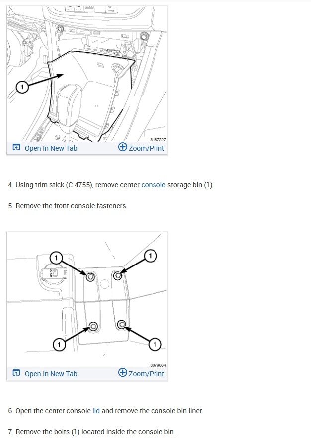

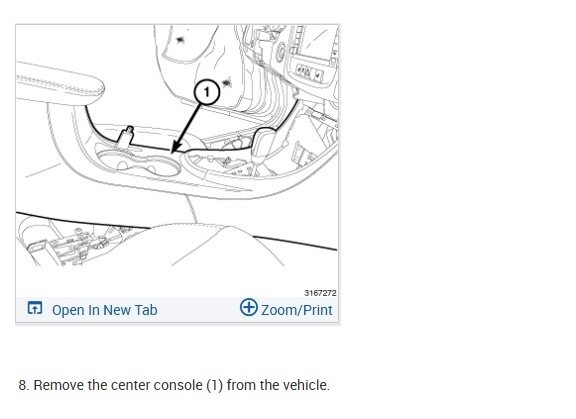

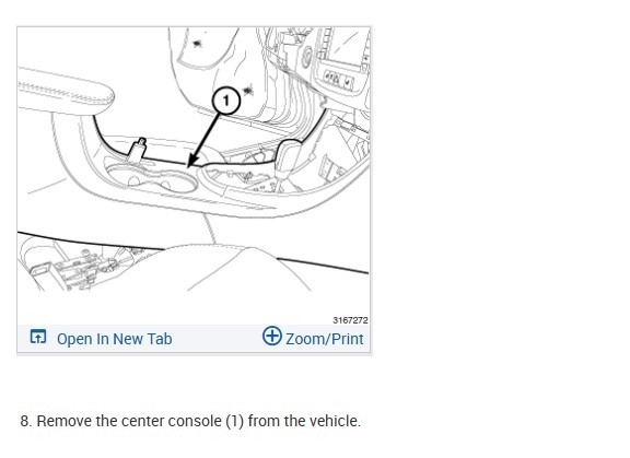

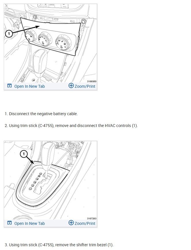

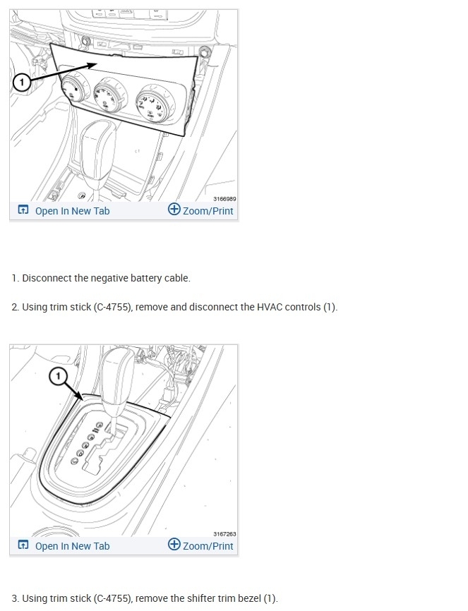

Heres the Center Console removal if needed.
May 26, 2024 at 9:25 AM
AL514
  • 5,464 POSTS
The wait time on the SRS is listed as only 2 minutes after battery negative disconnect.
