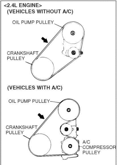

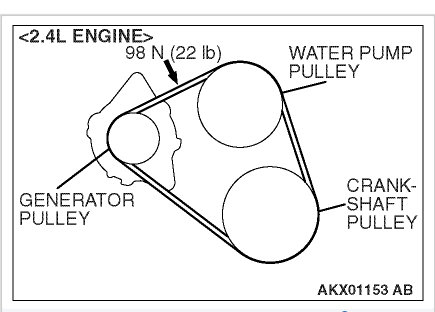

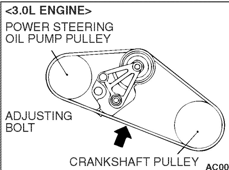

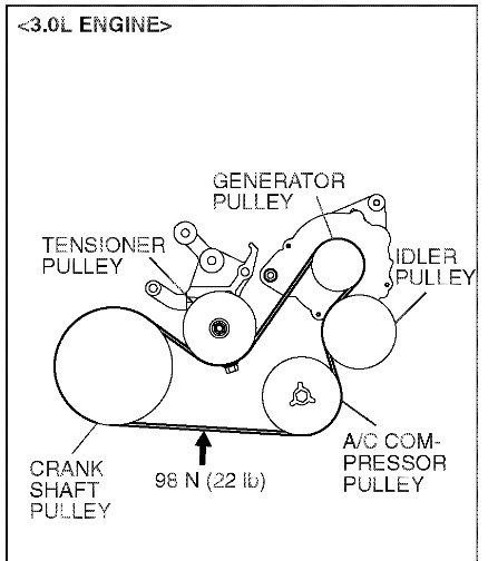

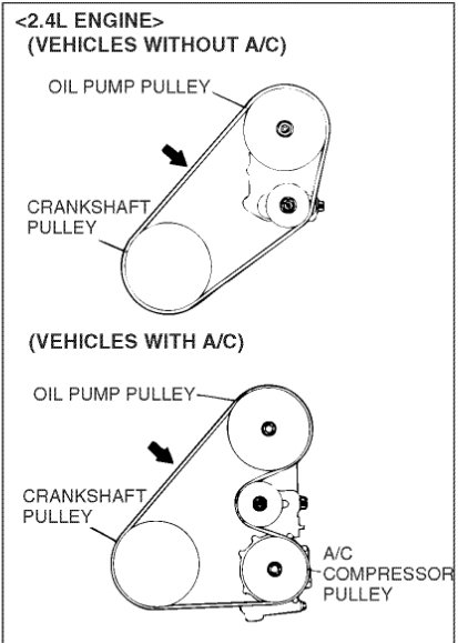

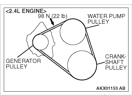

How to replace belts both of them?
Sep 6, 2019 at 3:37 PM
DANNY L
CERTIFIED EXPERT
5,648 POSTS
Hello, I'm Danny.
Here is a tutorial that shows what is involved:
https://www.2carpros.com/articles/replace-serpentine-belt
I've attached pictures below of its description/diagram. I've included both the 2.4 liter and 3.0 liter engines since you didn't specify yours.Hope this helps and thanks for using 2CarPros.
