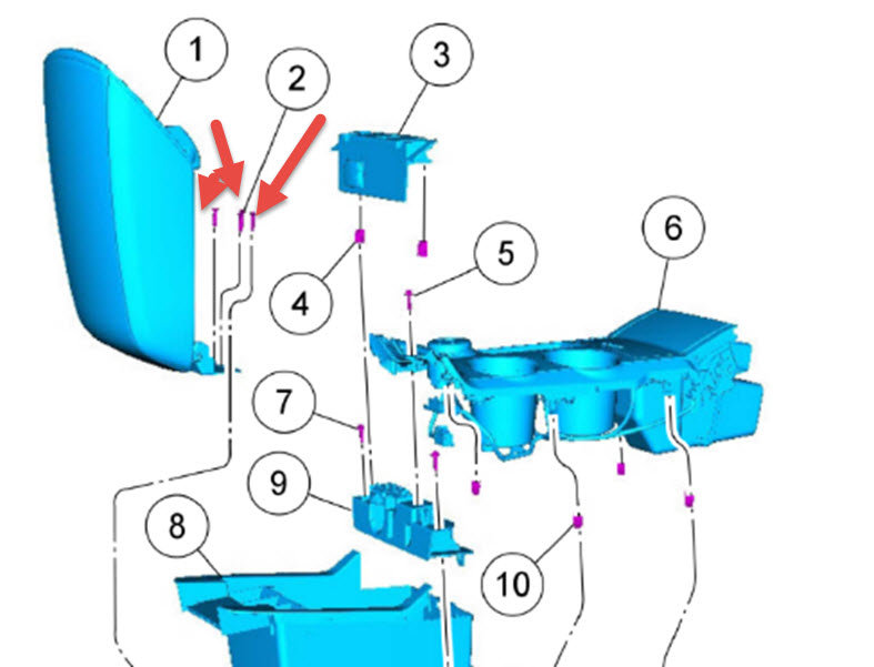

See picture diagram it shows four screws.

Thank you for the specs, I cannot get those screws. Frustrating

the screws may be torx bits which may be 10 or 15 size.

see if item 8 in original drawing I sent will pull up if not item 3should then remove screws on item9 then get storage box out to reach screws on armrest. we don't have clear instruction s on this and I really need to play with it to see how to remove it

in pic I originally sent item 3 needs to be removed to get armrest up if there are rivets in it then they need to be removed to get item 3 off then gain access to armrest screws. then rivets need to be reinstalled after repair.

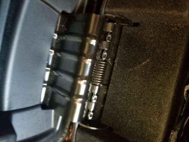

No, I was not able to. The diagram shows these screws come out, however the only thing that even resembles a screw is this picture which is actually the spring . I cannot figure out to remove. I finally just recovered the console

To remove the arm rest you need to remove the lower liner inside of the console. the bolts for the hinge are under that.

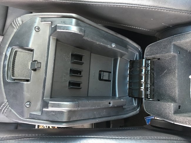

If you get the arm rest off, how do you remove the pad from the arm rest to replace the skin?
Jul 19, 2018 at 7:24 AM
CERTIFIED EXPERT
53,854 POSTS
Can you upload pictures of what you are talking about? Top and bottom then I can tell you how to get it apart for upholstery.
