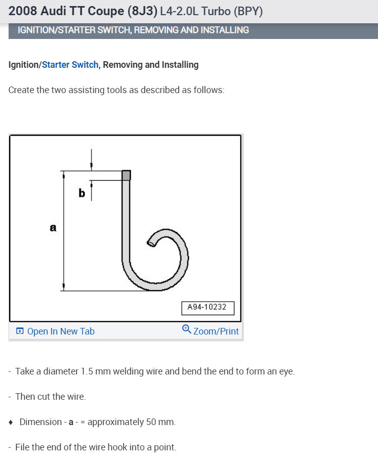

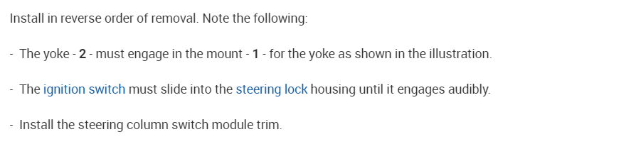

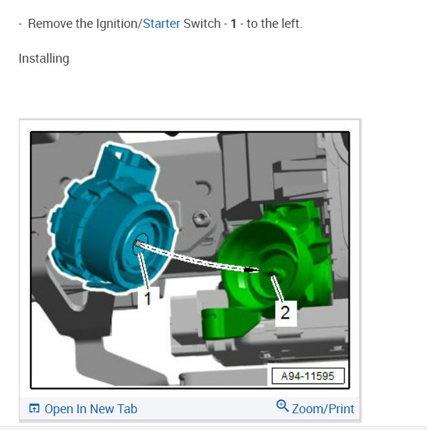

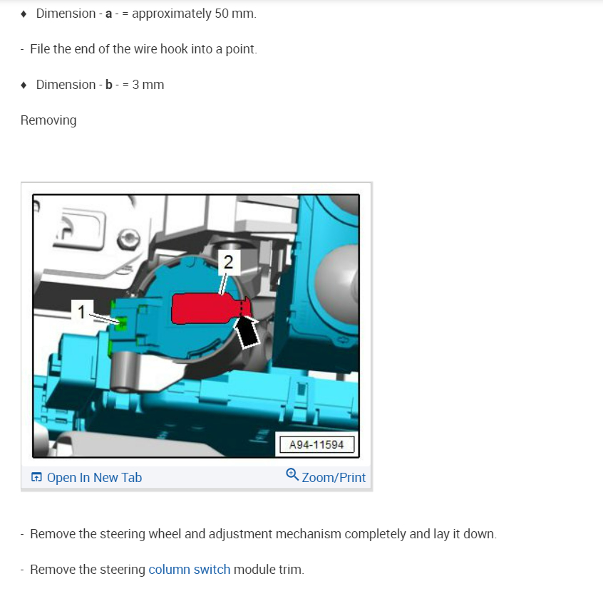

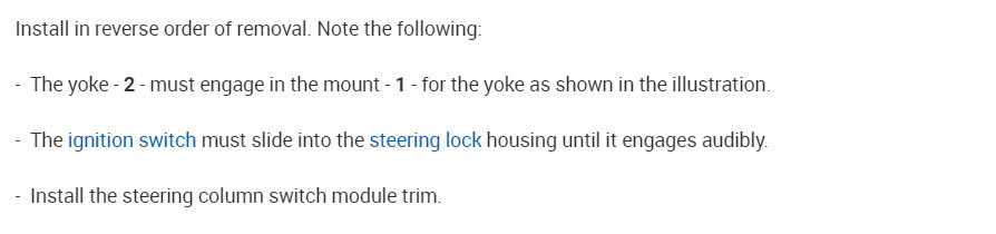

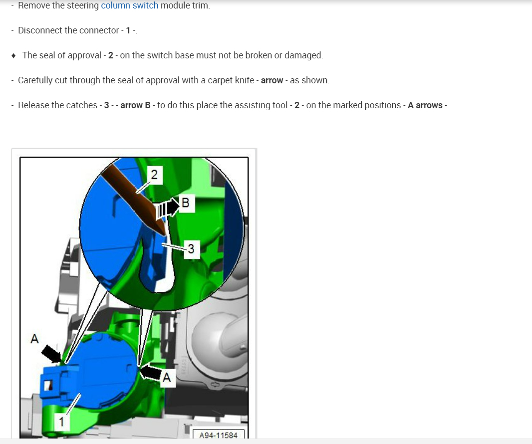

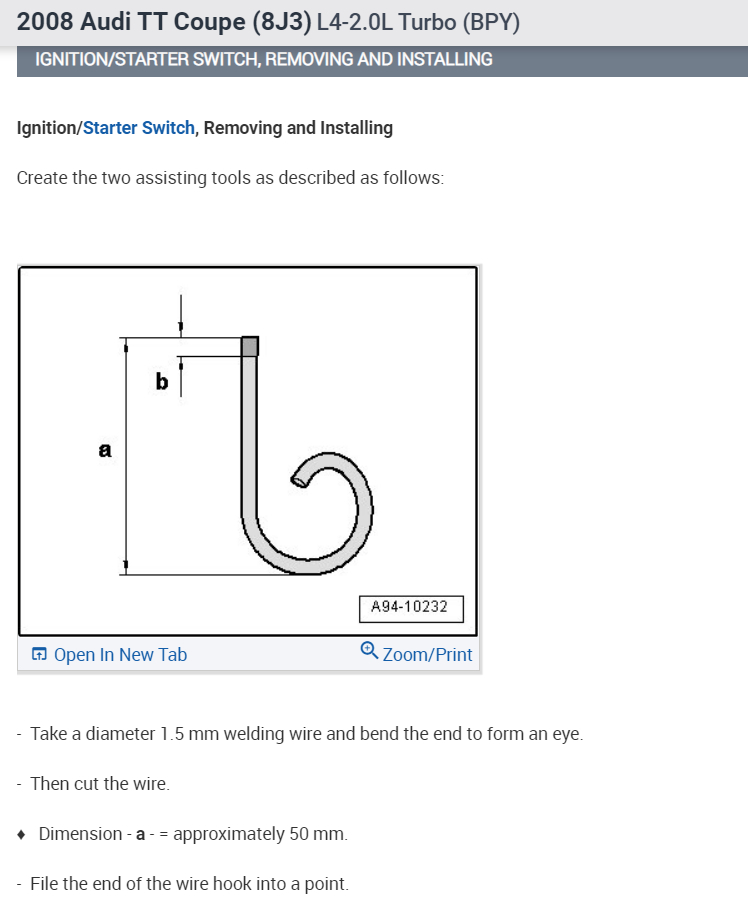

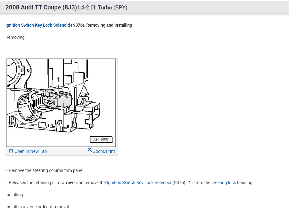

You will need to get the new code at the dealer/supplier and have your VIN number ready. Here are the instruction on how to replace the ignition switch and ignition key and lock in the
images below.

Check out the images (below). Please let us know if you need anything else to get the problem fixed.
