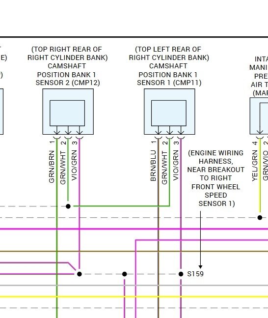

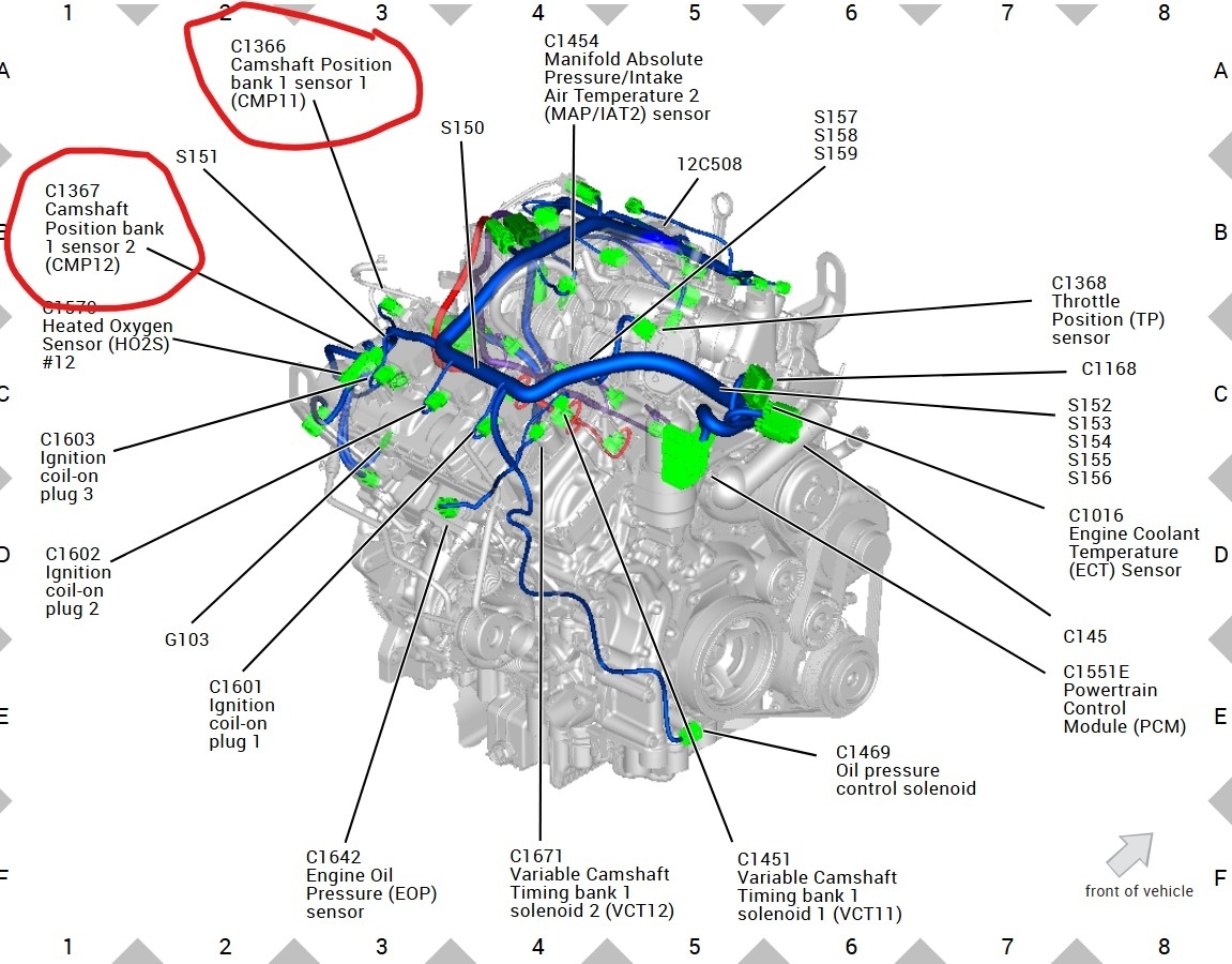

Code P0344 CMP sensor A circuit intermittent (Bank 1 or single sensor)
Need to figure out if bank 1 is the front of back of engine.
