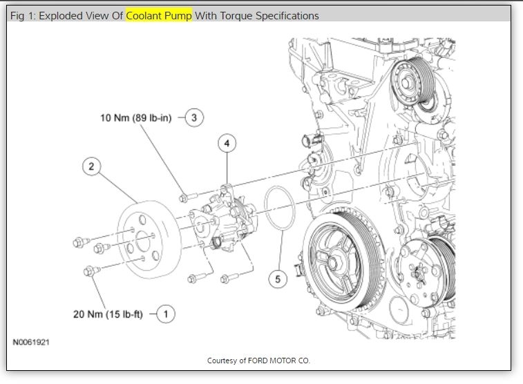

I need assistance with how to locate and replace the water pump.

Hello my name is Dave.
I have attached a diagram showing you the water pump including bolts with torque specifications. Hope this is helpful and if you need further assistance we will be glad to help, thank you for using 2CarPros!
