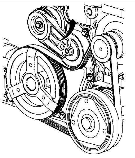

I've inserted a tutorial showing what is involved in replacing your serpentine belt:
https://www.2carpros.com/articles/replace-serpentine-belt
I've also attached a picture below showing the proper belt routing.Hope this helps and thanks for using 2CarPros.
