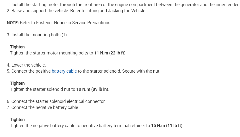

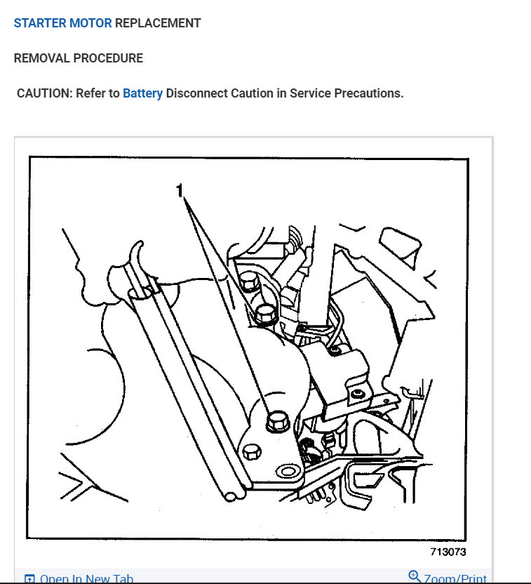

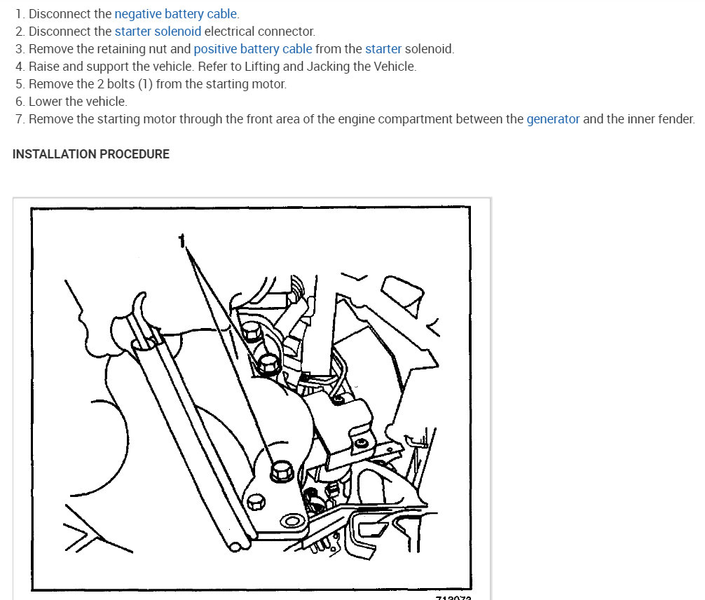

You will need to do the job from under the car so you will need to jack up the car. Here is a guide to help:
Here is a generic guide to help with the job with specific instructions for your car in the diagrams below:

I'm sorry but this doesn't really help. I don't know what angle in the diagram I'm looking from. I need step by step with photos or video to fully see how to and where to finagle the starter out from if I even can get past the rusted bolts. Thank you and I mean no disrespect I just don't understand.

These are all the diagrams we have for this car; can you upload pictures or a video so I can walk you through it? Also let's load test the battery by following this guide:
You may have a bad ground cable to the engine block or positive battery cable. Let me know
